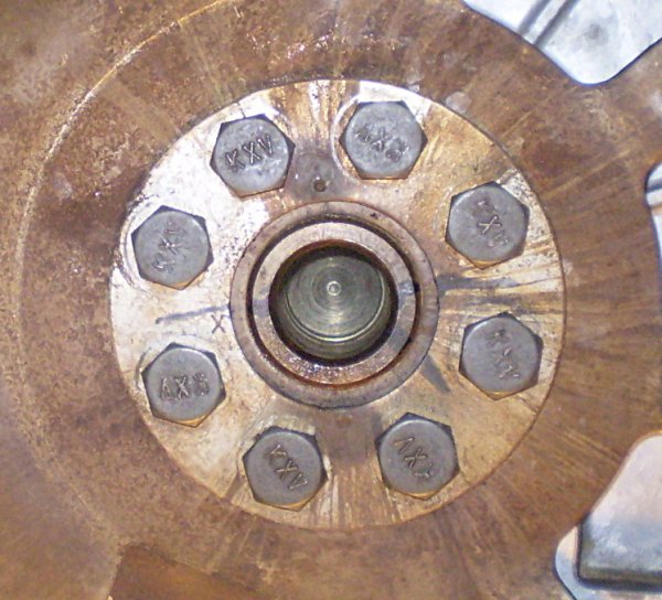

    I bit another bullet and ordered a set of the flexplate bolts. One time use torque to yield bolts are not suppose to be reused. I risk these bolts loosening under the vibration etc of the engine and if they loosen it could cause serious damage to the torque converter housing and that would be the end of the transmission. I was able to get a set a bit cheaper at $32.78. I found them cheaper at several places but by the time I paid the shipping, I was back up at the same price. It is what it is I suppose. I am sick of this project; the time involved and the costs involved have been depressing. I want this project behind me.

  13. brenndatomu
    25,181
    163,744
    There is exactly zero chance I would have put factory bolts back in there at almost $40...a trip to Fastenal (or the hardware) and less than $5 would have me ready to assemble...
    HDRock, yooperdave and Boomstick like this.

    True, I could have taken one of the old bolts and got some grade 8 or better replacements. Then there is the question of torque; which I could probably guess at around 50 ft-lbs. However, there would still be questions if the bolt will do the job. The original designed for this application called for TTY bolts; where you do a light torque to set the bolts and then a degree setting to achieve the final pressure on the plate from the bolt head. If the engineers decided this was what was needed for this particular application in the engine, I feel better about going back to the original type of bolt and torque method. Reusing the old bolts with locktite probably would have been OK, but I would have jumped every time I heard a noise. I had a fire to happen on my old Ford Taurus I had; a small leak develop in the plastic fuel line that dripped onto the hot manifold. Luckily I had stopped at my friend's house and someone leaving saw the smoke coming out of the engine compartment and my friend grabbed a fire extinguisher and was able to put the fire out before it destroyed my car. After that, I was scared to drive the car, every time I smelled anything I was sure the car was on fire again. I would stop and raise the bonnet checking for fire.

    I have the bolts; not sure I can return them. I am not exactly happy about spending over $32.00 for a set of bolts. These are GM bolts so I know they are over priced but I could not find them from any other source any cheaper.

    I could tell a difference with the new bolts when I hand installed them over the old. Inspection with a high power lens definitely showed a difference in the threads of the old bolts. I might could have gone with the old if I wanted to use a blue locktite for added security but even then I would worried.
    Here is a photo of the new bolts installed. I torqued to the base setting but I had to use a foot-pound torque spanner. I have a inch-pound but it takes 1/4 inch sockets so I am going to have to make an adapter for it tomorrow as I did not have the proper socket. I don't trust trying to get a proper toque when you are at the end of the range. I am suppose to do a base torque of 106 inch-pounds then a 50 degree turn. I will have to make a gauge as I don't have one of the degree thingys.
    I noticed the markings on the new bolts is KXV. What does that mean?
