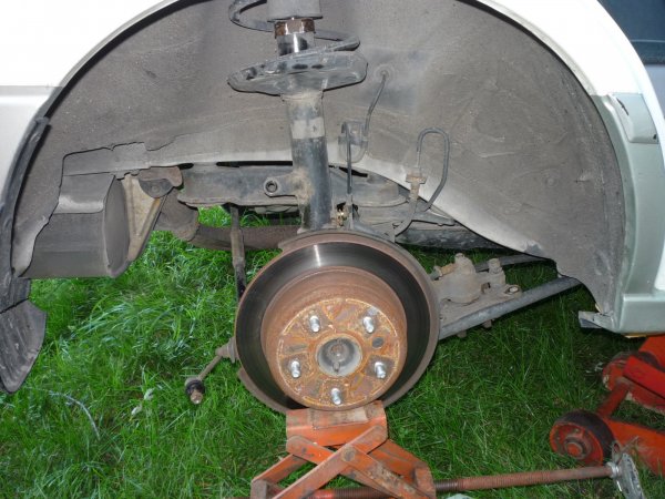

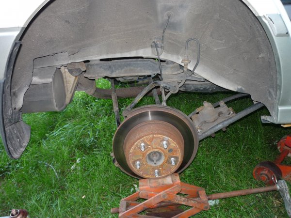

    I replaced the rear struts on my car today. Had to remove the brake calipers to access the lower bolts and the back seat for the upper ones. Even with the seat out it was a PITA to get those top bolts off and back on. Took me almost 4 hours for the entire job. That's about as much tear down of a vehicle I care to get involved in anymore.
    Here's a pic before I lowered the rotor to remove the old one from it's overhead moorings. Then one with it out.
