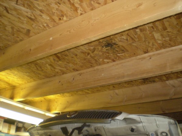

    Describe or post a pic of your ceiling Kimmie....

    OK. It was framed out in Frasier fir. If I had known, I would have insisted on some double beams in the middle; preferably yellow pine. I look at the cost differences between Frasier fir and yellow pine and it isn't that much of a difference.

    The bonnet is not going to clear the ceiling and it will need to go almost vertical so that I have access to the engine bay. Plus, the centre of the engine is not going to fall under a beam.

    Just looked at some images on the interweb. Many use a single 4x4 in the centrre. I wanted to put part of the force on the strut columns instead of just all the force in an area along the fender panels. I think if I add two more 2x4s, front and back, it will support the load of the engine and be distributed at two points instead of just the one as a single 4x4 would be.
