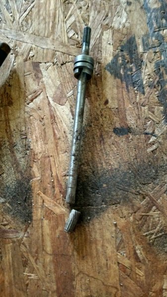

    I've done it several times, here's a video a guy doing the same I've done 7/8th chain done noids, I even did the 300m that way(into mounted converter). In hindsight doing upgrades to is easier on the bench. I don't think I'd pull the trans just to swap a chain though.
    I actually snapped the pump shaft after not knowing I lost a locating pin inside and the pump injested it :hair: the kid days :rofl: :lol: IMG_20170713_142030563_HDR.jpg

    The video won't play for me. I heard the early models of the GM 4T65E (my tranny) the input shaft would break. They later hardened the input shaft to prevent this. Good possibility that is what happened with me because it is completely no go. I don't have the means to pressure check the unit but my feeling is that the pump is not being driven so no pressure. The pump on these is a standard vane pump and those things go and go until they wear out and loose pressure but they don't just fail catastrophically; or least I haven't seen such.

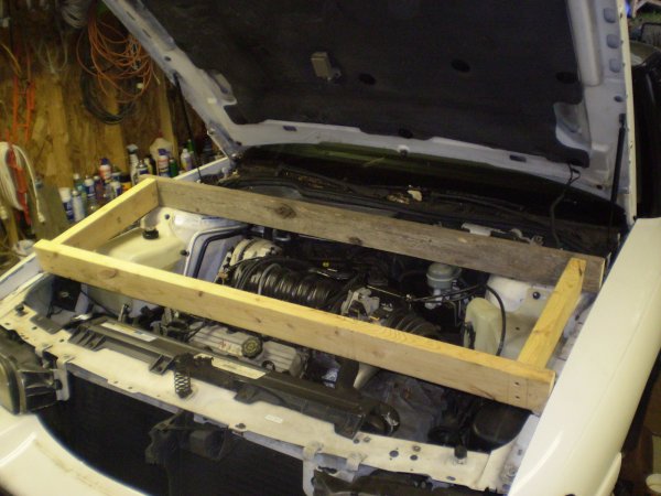

    Here is my DIY engine support; the cross pieces at the end have to be angled to the back support and slightly angled to the front support. There are host points in the front and rear so I will be distributing the weight between the two 2x4s and the wide side is vertical. The engine weights roughly 400 lbs. The span of the 2x4s is less than 5 ft/154cm. I think the lumber is yellow pipe; not sure as I did not purchase it. Anyone have any data on yellow pine? The front hoist point is more or less going to be loading in the middle of the span. The back hoist point is going to be towards the passenger side. I remember doing these calculations in statics class. Just need to be safe although when I am under I will have have something under the engine just in case. Then when ready to pull the trans, I hope to be out from under the car so I can clear the area.

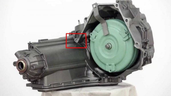

    I finally saw the rear bolt today. The location is marked in red. Looks simple but there is exhaust manifold and brackets etc. Also imagine the engine bolted in place and you can understand why this was so difficult. I was able to peek through a hole at the passenger side and see the bolt. So now I know where to try and snake the extension bars with the socket. The hard part will be putting it back in.

    No one answered on the engine support and since the engine falling on me can kill me, I think I will additional 2x4s.

    I don't see anything marked in red... I do observe an overhaul job that would have me seeing red, tho....:mad:

    You don't see a red square outline just to the left of the centre of the torque converter?

    Can you span atop the front pine 2x with another laying flat, making the shape of a T? That would add plenty of strengths....

    24,554
    141,625
    Where is this "centre?"
    :salute:
    J/K ya....it's there. I couldn't resist myself.... Stevie Wonder could see that red box....:wacky:

    I don't have any timber here; well, there are trees but no way to mill; I have looked at the milling forum and that is neat stuff. I will get my sister to bring some more when she can.
