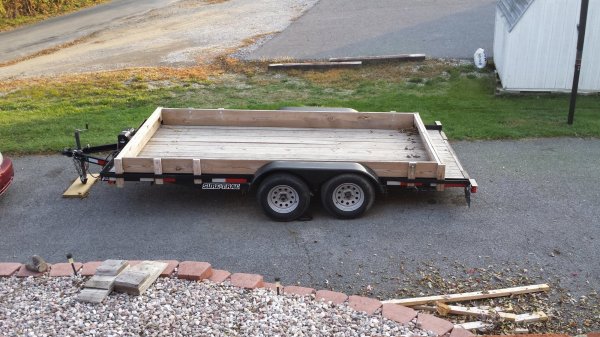

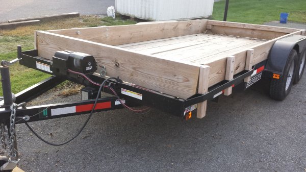

    Here's mine. Wouldn't mind a gooseneck but I really don't have a need for one right now. I have some marks on mine from various cars and equipment for tongue weights. Trailer works well for what I do. 1445428658879.jpg 1445428718400.jpg
