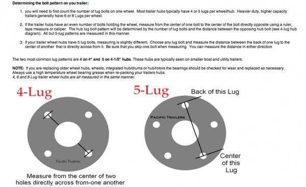

    Pallet Pete , are these 15"?

  10. Horkn
    29,159
    166,369
    Compass, liberty, patriot, wranglers through 06. All old Cherokees, etc...
    The lower end optioned vehicles had steel wheels, like patriot, wranglers, Cherokees.
  11. papadave
    Well, that trumps my limited (and at least partially incorrect) info.....great find Horkn.:thumbs:
    Horkn and LongShot like this.

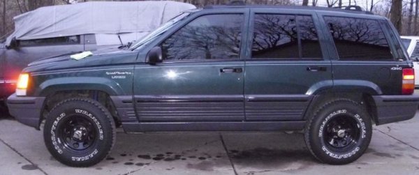

  14. HDRock
    17,262
    60,487
    Ya can't have my wheels I need em :)
    There's a lot of jeeps in the junk yards on Dort Hwy
    92
  15. Pallet Pete
    Pallet Pete Moderator
    13,479
    54,102
    Ovid
    Thanks everybody! Lol I don't want your rims HDRock but those tires well that's a different story! :rofl: :lol:
    HDRock likes this.
  16. HDRock
    17,262
    60,487
    those tires are from Craigslist:thumbs:
