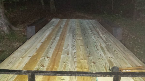

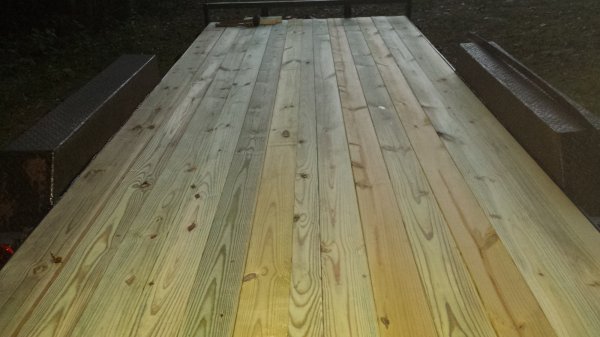

    I wanted it done!! I ripped the 2x6 and it fits like a glove!! Now I just need to tack the angle iron piece that hold the front edge of the boards down and the deck is complete and I can be on to some siderails.

    Looks good. :yes::thumbs: Just be sure and stain that wood.
    Certified106 likes this.

    Looks great :thumbs: much better than it was.
    Sometimes its just better to go ahead and get er done, rather than waste time and save a couple bucks
    Certified106 and Stinny like this.

    Probably will next summer. It is way to wet now and needs to dry out a while first.

    Well you got it all fastened down so it shouldn't warp out on ya much at all.
    The worst is over getting all the old paint off:hair:

    Get them fastened down quick. They are going to wander all over as they dry.

    You all really think they need fastened down? I have never owned a trailer that had the deck fastened on it and have never had an issue with any of them.

    I personally would put a carriage bolt with a locking nut at each cross member if using wet treated lumber. I wouldn't be as concerned if the lumber was dry rough sawn.
    I've seen treated do some wild things as it dries and the last thing you want is the board arching in the center and rising up off the deck. It would be loud and beat the board to an early failure.
    Did you check the crown on the boards and orient it facing up? Having the crown up is good to prevent them from gathering water....but boards will also tend to arch in the direction of the crown too.
    If the wood wasn't "soaking wet" I wouldn't be as worried about it.

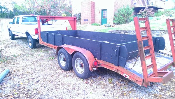

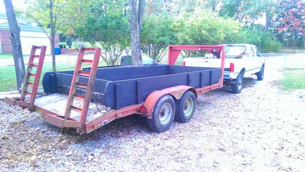

    I added another board to increase the height of the side boards the other day. I see that your trailer has side pockets too.

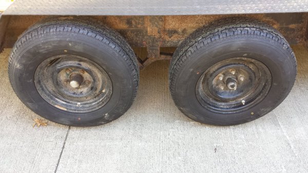

    Just got 4 new tires mounted and on the trailer today! Its coming along nicely. Next up some side boards! uploadfromtaptalk1445089001055.jpg
