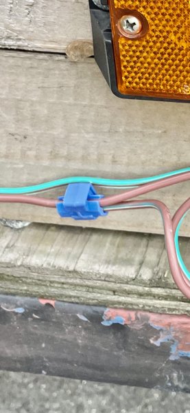

    The reason I like the splice connectors is because I have 3 - 14 Guage wires to connect. One that goes to the side marker light and the other 2 which one comes from the harness connector up front and then goes down to the tail light which I do not even have to cut and strip. If they have 3 way waterproof butt connectors that might be a solution?
    See pic below

    Twist two wires stick them in one side of the butt connector then stick the 3rd in the other side.

    Any scotchlok type connector is banned in my shop...they make a very poor connection.
    And any connector with heat shrink that says it's waterproof is not, unless it uses some sort of grease inside...that's the best way to handle this, a butt connector or wire nut full of silicone or dielectric grease...or, make all connections inside a watertite junction box...but NOT with scotchlok!

    Those might be handy as a temporary fix, but they pinch and damage the wire. Anything that gets left outside like that is only going to last a couple years. I would never use them on anything I wanted to last

    It’s difficult to get folks to understand that. That stuff is acceptable for a teenager to hook up a radio under his dash, but that’s where it should end

    I really do have a long standing hatred for scotchloks...they cause nothing but grief!!

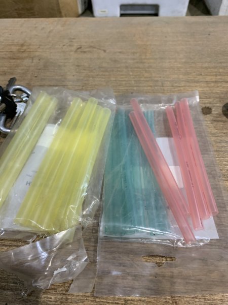

    image.jpg If you go the solder route get some heat shrink tube. Much cheaper than the wrap.

    Yes but then I have to cut the wire or can I slit the tubing and wrap it and Shrink it??
    Horkn and brenndatomu like this.
  17. Warner
    Warner
    Jun 19, 2017
    7,368
    47,706
    No you would have to cut the wire.
