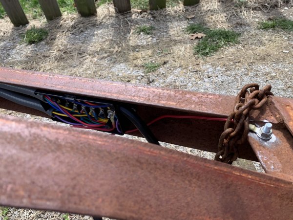

    Just got done, hopefully this will be the last time for this trailer.. Ran all new wires, soldered & shrink tubed all the wire lights. I did end up using 4 of those connections ( Nixon ) on the brakes, couldn’t get the soldering to go this morning in the wind. But it’s verified and all works, ran a brand new ground wire to the frame also. I now have back up lights and trailer Brakes.... :dex: ... Thanks for all the advice...

    Awesome. If you haven’t put the cover on the junction box yet.....smear some dielectric grease on all the terminals. That’s always the last step in case you need to fix a circuit or got a wire in the wrong spot. That stuff is gross when it’s fresh lol.
