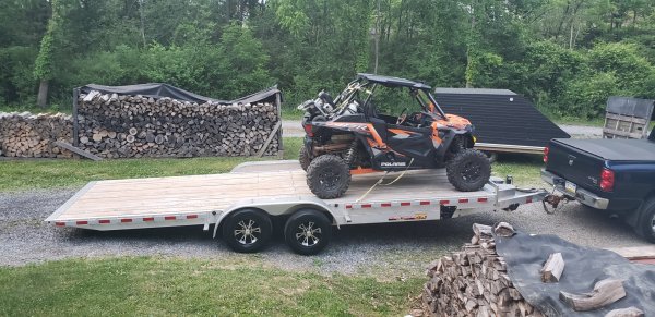

    I like my tilt deck.
    H&H aluminum 22' 10,000 #

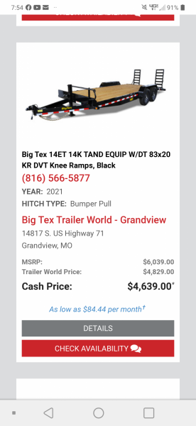

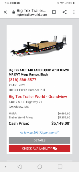

    Yes, they are relatively close. I was looking at them earlier too. But I know the brand seems to be good. The towing capacity of my truck is like 10K. Would 14K be overkill? As long as I don’t load it beyond the 10 K? Which I don’t think I’d everyone get close anyways. Just talking out loud here...

    Tilt decks are sweet...so is aluminum...when new. Once they get some age and miles on them they often start to crack...and used aluminum is very difficult to weld on!

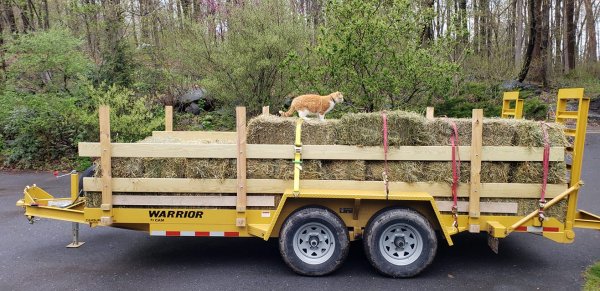

    Take a look at the registration and towing lows in your state for registration pricing, inspections, brakes, CDL, etc. I'm no expert but there are usually break points for these. I'm real happy with my CAM Superline "Warrior" 10K equipment trailer. Very simple but very high quality at a a great price (16' for $3695, 2020 Cam Superline 76.5' X 18' 10K "Warrior" Equipment Trailer | Performance Trailer Sales in White Marsh MD | Cam Superline Trailer Dealer in MD for utility trailers, flatbed trailers and enclosed trailer dealer in MD) but I believe it is only available in in 16-18'. Deck over and aluminum are nice but the price goes up quickly.

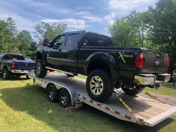

    Removable fenders are good for loading big trucks with wide wheels/tires 20263.jpeg

    Almost hate to ask...but what's up with hauling the 'stroke? (and where is your FHC window decal Mr?! ;))

    Stake pockets are must so you can add walls to carry firewood, etc. Rub rails are really nice to have, too. These allow you to attach your straps/chains anywhere along the the length of the sides. My trailer doesn't have them... yet. I will have a local fab shop weld some on soon.
