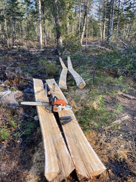

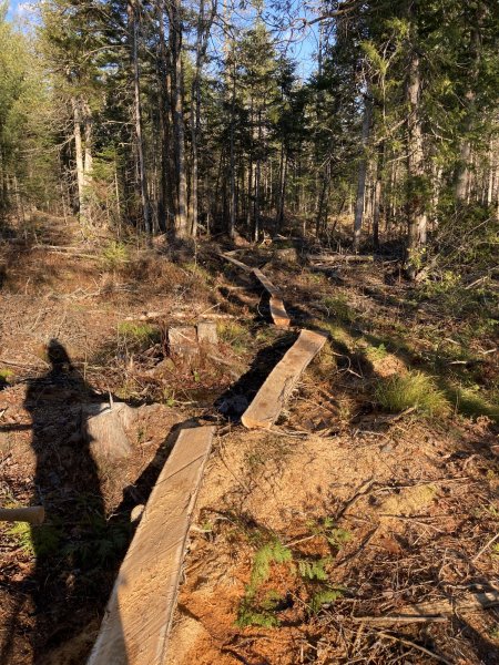

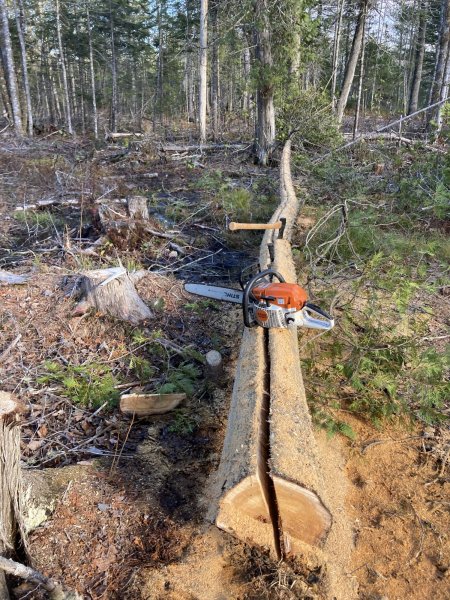

    I got tired of hauling planks a half mile out in the woods so I decided to just fell a cedar and free hand rip it with the 261. Worked better than I thought it would. Just carve a flat spot on the end for a place for it to sit on the bunk and drive a timber lock through. Beautiful day to be in the woods.

    Looks like a great time to be had. Your freehand ripping looks straighter than half of the lumber you'll find at the local big box orange :thumbs:
