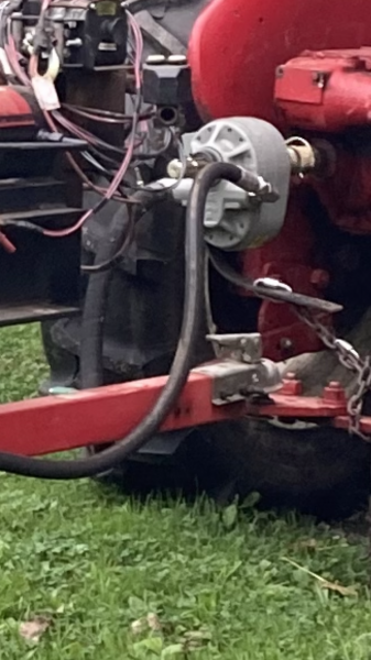

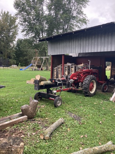

    Just to throw this out there….
    Tractor run log splitters
    I’m happy either way. It was fine when it was self powered and I like it just as much now when it’s on the tractor. Guess it’s a preference and all about what your circumstance is.
    507B70A1-A340-48DC-B805-754DD42540AB.png D55C0928-0D0F-4252-989B-7C10256198AA.jpeg
  8. MasterMech
    9,648
    26,048
    Greenville County SC
    Sometime's you just gotta hear that Farmall four-pot purr.... Looks like a therapy rig to me. :yes:
