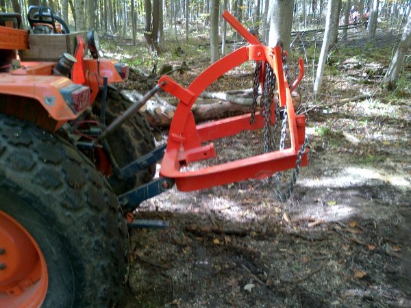

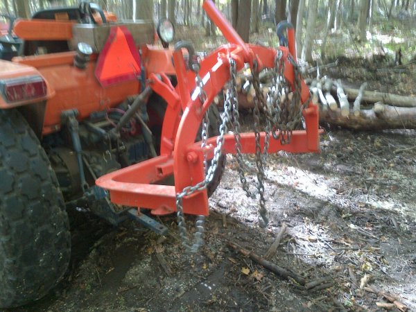

    I'd be awful careful with that - your hitch looks way above your rear axle. If a log that size were to meet something immovable (stump, rock), the high hitch works as a lever to flip the tractor over on its back. If you look at a commercial 3-pt skidding winch, the hitch point when skidding is much lower.

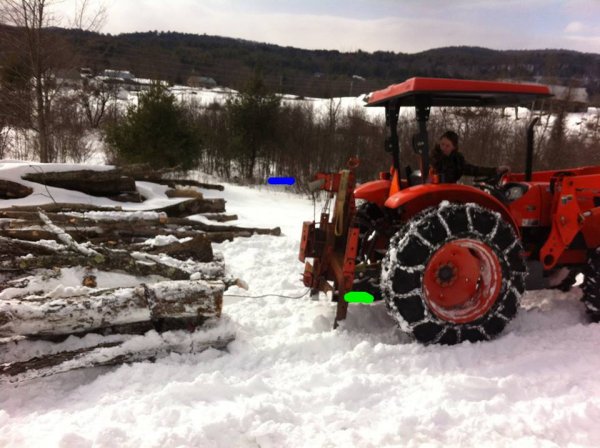

    In the picture below, when I winch the log to the tractor I'm pulling from up at the blue line, but I am off and back away from the tractor when I do that. When skidding, the log is attached at the green line, not the blue line.
    I've had farm tractors on two wheels before when I wasn't expecting it, and got lucky. Just be aware and give it respect - stuff goes bad fast.

    Not to argue your point (because it is a safety concern), but if you look at the commercial skidding plates available from several manufacturers (Wallenstein, Erskine and Quick Attach as examples), the general geometry of the skidding plate is remarkably similar to the OP's design. The hitch point for the chain choker is well above the lower three-point arms. Most commercial three-point winches have a notched bar up fairly high on the winch, at or above the connection point for the top link.
    However - where the commercial designs differ is that they are constructed with that beefy bottom blade, which serves several purposes - it acts to prevent the tractor from being dragged backwards when winching, they protect the lower arms from damage if a log were to swing forward and contact the hitch pins, and they act as a first line of defense against that rock or stump (the potential hazard) you mention. If the log is chained up high enough, the first thing that will hit that hazard is the bottom blade, and the rest of the log will slide right over it.
    So - advice to the OP - outfit that design with a solid steel bottom blade, or a piece of heavy channel iron or something to prevent contact between end of log and hazard. You do want to get that butt end as high as reasonably possible to prevent it from digging in and flipping the tractor over backwards. Less log contacting the ground also means less dirt and grit getting in the bark.

    That did occur to me when I was making it, but I just don't see how I would get the butt end of the log higher than the bottom blade without a winch.

    Easy. If you were to put a blade on the bottom of that, when you backed up to a log, you'd lower the blade all the way to the ground. Chain up your log as tight as you reasonably can, and then lift the 3-point. The blade and the bottom of the log will be close to the same height off the ground. Doesn't need to be *higher*, just need the blade to intercept the hazard first.

    Agreed- mine is an older winch, and at times I do wish it lifted higher when skidding, and I really wish I had the butt plate to hold logs back when going downhill on snow.

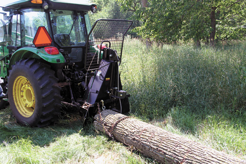

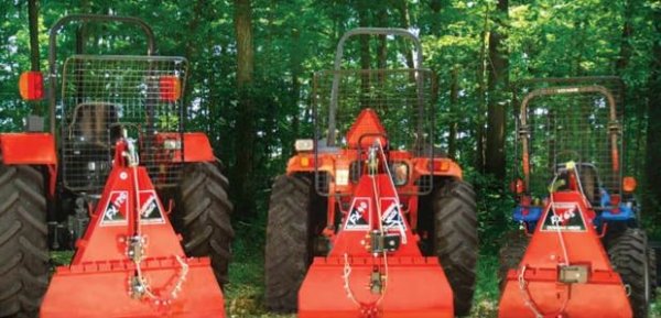

    Here's a couple of pic's of commercial winches (Wallenstein, and Erskine (I didn't know Erskine made them)). You'll see the notched bar for the chokers is much lower than the top link. Then look at the OP's first photo, and note the height of the hitch point - I was comparing it to the axle height, but maybe the top of his tire is a better reference point, as it appears to be well above the tire.
    In addition to the butt plate, another way to add a measure of safety would be to lift the log, block under it, re-chain tighter to the hitch point, and skid with the 3-pt at a lower height.
