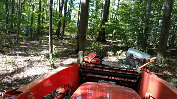

    ^^^This. Of course this pic has me carrying out my bucket on my forks with wood loaded in the bucket since I swap between them to fill the truck with firewood length and the trailer with log length.
