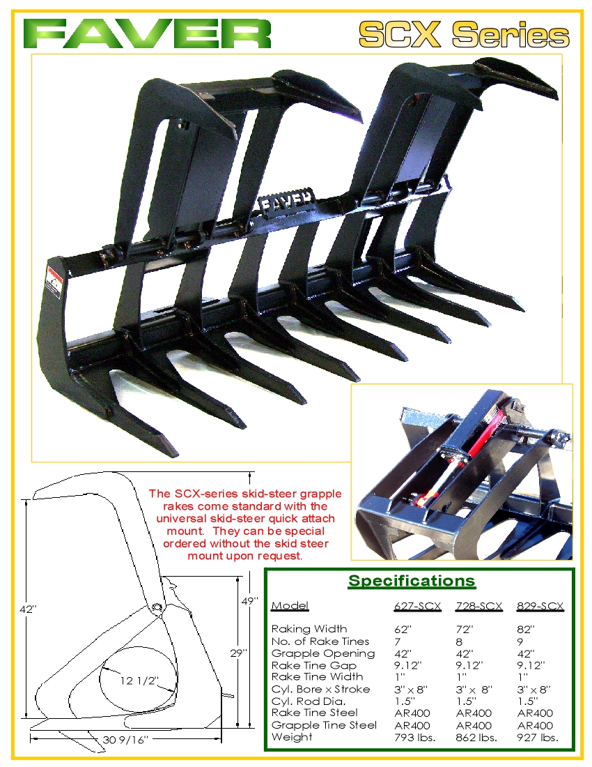

    I had not considered the weight to be an issue. but that is good to think about. I did a quick search. here is a 72" grapple that weighs 700 lbs. vvvv
    this 72" weighs 862 vvvv
    here is a rock grapple that weighs 988 vvvv
    Rock Haul Grapple Skeleton Rock Bucket
    so all in all, you are correct about the weight issue.
    when I first read this I was like "Huh? they both have teeth." then I realized you were referring to the fish hook style barbs on the inside of the grapple teeth. and that is something I noticed. like if you tried to grab the round end of a log and pull it. it would slip thru the teeth on the faver grapple. but the faver also have bigger cylinders for more clamping force, so its a trade off. which one is better? I can't say, depends on the situation really.
    another difference I notice is that since a root grapple's teeth are curved up at the tips they are designed to be operated like this. vvvvv with the bucket pointed down at about a 45* angle. vvvv
    any operator will tell you that it is much slower and more tedious to run a machine with the bucket pointed down at a 45* angle than running it flat. simply because its more time consuming to set the bucket to the right angle when returning to work after dumping. also the bucket will want to dig and gouge so as you drive forward you have to drive much slower.
    this tine bucket on the other hand you can quickly drop back flat to the ground and when you drive forward you can drive much faster, and more efficiently.

    I really like the Faver model with the flat bottom/tooth design and the one concrete grazer posted with the similar design. I am seeing a lot of practicality to each. I think they would work well for logs. and I'd go crazy cleaning up skid trails, etc.
