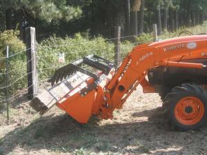

    004.JPG I had a set of forks so I bought a grapple to go on it. It was only like $400 +/- on eBay. Works good for me and I pull the pins and take the grapple off if I just want to use plain forks. Came with the cylinder and everything.
