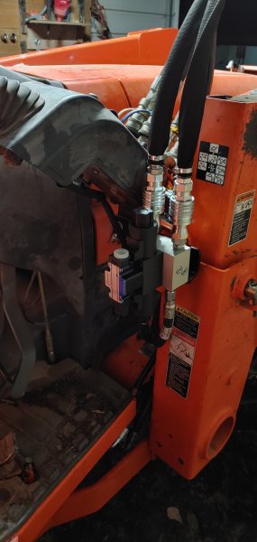

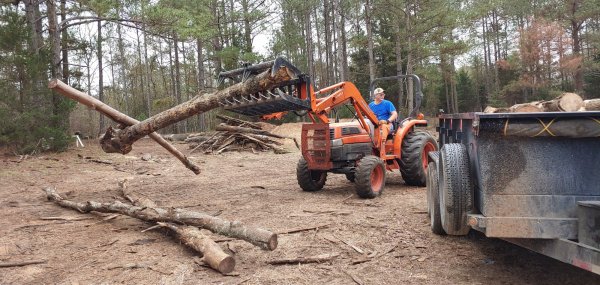

    Great ideas on the tractor mods. We got the Grand L3130 model, so it came with rubber floor mat, the sliding pin style stabilizer bars and it has the slide out ends on the lift arms. About the only things we have added was 3rd function valve, changed loader from pin on to QA 0221212320a.jpg 0221212321_HDR.jpg
    I did get a shim set, added 1 to the relief valve, increased the lift capacity on the loader.

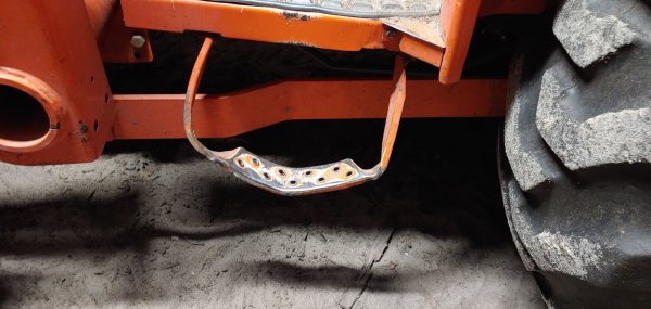

    We have gotten a new step, too many years with a fat kid:whistle::whistle: stepping in the middle and several limbs or small trees bending it...I want to weld up a frame around it with better bottom support 0125221830.jpg

    Also...sorry about your step !

    The picture with the cantilevered log is a good way to break/bend the loader. When one cylinder is supporting the log the other cylinder is doing its best to twist the little tube that connects the loader arms together.
    I've fixed a few over the years and I can say it's not pretty.
