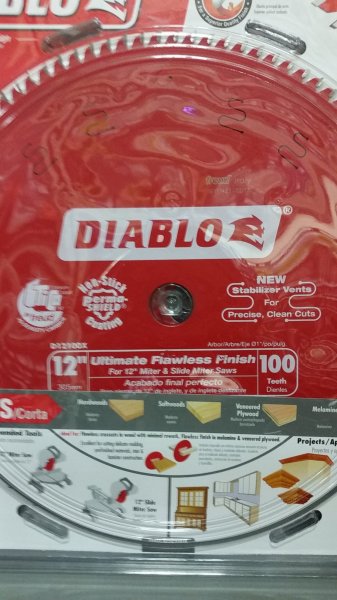

    Saw this at HD. Looks like most teeth for 12" in stock.

    In my experience it varies by manufacturer. With my Forrest blades the 100 tooth 12" is about as good as it gets... The 80 tooth 10" looks equally good. I have run a 12" 80 tooth and it has just a fraction more chipping than the 10" version but that's is me being picky in all honesty it looked very good and clean.

    There was also a 12" - 96 tooth for laminate. Didn't see if it was thin kerf.

    Probably won't see much difference with 12" 80 tooth but I'd go with the 100 tooth .
    That 100 tooth Diablo has an Axial Shear Face Grind , the 96 tooth has a triple chip grind , TCG are nice to have around for cutting laminate, plastic , melamine , aluminum.
    I have used my triple chip blade on veneer faced plywood , it does a real nice job , cuts aluminum real nice too
