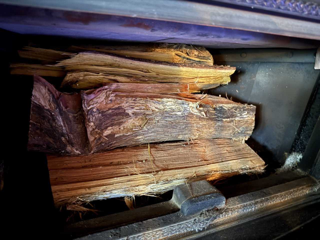

    Ok, in the interest of science, I documented tonight's fire lighting of a top-down burn. Outside air temp: 56F. Obviously bad conditions for a quick light. I'm running redcedar here. 1 fatwood and a handful of random cedar and osage tinder seen up top. I am going to start the stopwatch BEFORE even pre-heating the flue.:
    Time: 4:21
    Immediately off to the races. Hold the door a little bit closed to amplify the air velocity, and then..
    Very lit! Time to close the door now and start building airflow:
    Perfect. Secondaries lighting off. It's now 4:26. It's been _five_ minutes and secondaries are already lighting off, and it's almost time to start cutting air down.

    cezar, that looks good. It seems top down might be good for smaller fireboxes with secondaries above. That may be the difference in opinion and experience here. I have a big firebox (5 cu ft and no air tubes) in my cook stove, and I know other members here have big fire boxes as well.
    I have been thinking about adding air tubes, but have been too busy to actually do it.

    This is basically identical to my process. Works well for the Oslo.
