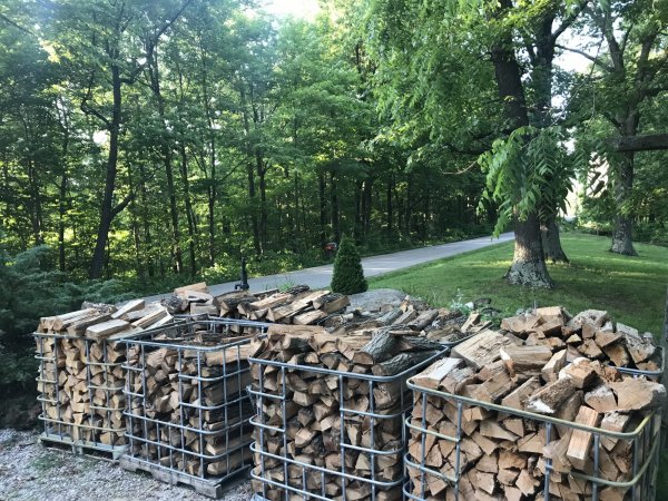

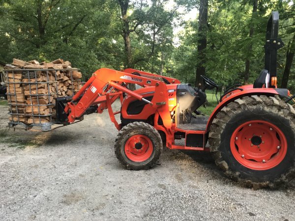

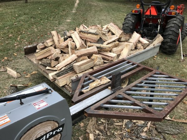

    Using these totes has really streamlined my firewood hoarding. I cut, split, and load these up in the Woods. I don’t touch the wood again until it goes into the stove. The addition of a table to the splitter really helps production too.

    Great idea and cheap too.

    Nice setup

    They aren’t too bad, I ended up with about 25 of them. It’s starting to add up...

    Hey webby3650. I really like your modified table on your splitter. I have that same splitter, but it is still stock. I’ve had it about three years, and I have always thought the table design was the weak point in the splitter; not nearly as efficient and functional as it could have been. Yours is similar to a lot of the newer versions of kinetic splitters that are out there. But I’m sure you know that already. Did you do the design yourself? Any input you can offer. I’ve been thinking about modifying mine, but I figure I should learn how to do some welding first. It’s always on my list, but it never seems to make it high enough up to the top that I actually get to it. Thanks.

    I bought it second hand, I can take some closer pics if you want.

    If you wouldn’t mind, that would be awesome. I am curious to see how the attachment points to the frame were done. Thanks very much!

    I think you got a ways to go...25 totes might impress on some sites...but this is THE Firewood Hoarders Club after all...;) :p :D
