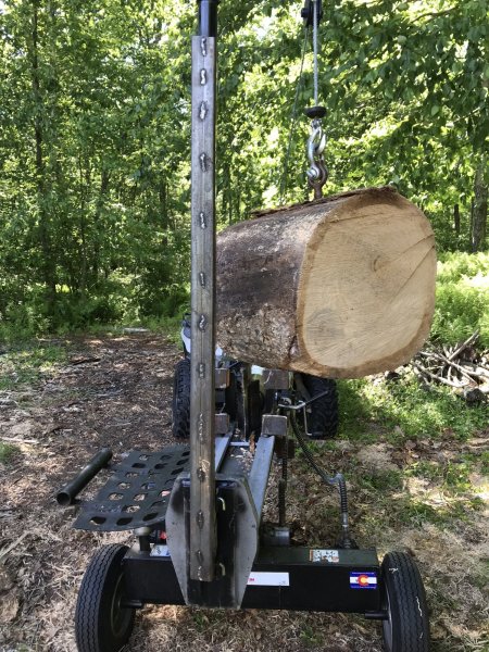

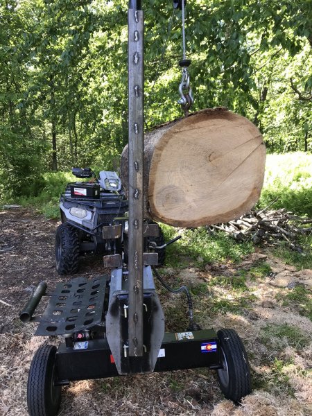

    Yeah I built something similar. Used the winch on my atv. No sense letting a machine go to waste while I break my back.
    Instead of that screw in Gorilla thing I use “Rafting Dogs”. Work great. Couple good whacks witha three pounder and your all set. Recommend never getting underneath one just in case it pops loose tho. Not many people would make that mistake once, certainly not twice. LOL
    Have a separate car battery wired in to the winch instead of killing the little atv battery. Winch comes with a wirelessremote which is nice. Only con is the remote turns off between rounds. Takes about 5 seconds of button pushing to fire it back up. Oh the agony!!
    One last hint. Build the pipe much stronger than you think it needs to be ;) mines scabbed together because I didn’t :)

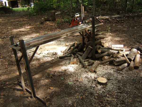

    My design chop saw for 10" and smaller rounds. Especially handy if you have alot of tops to process.
