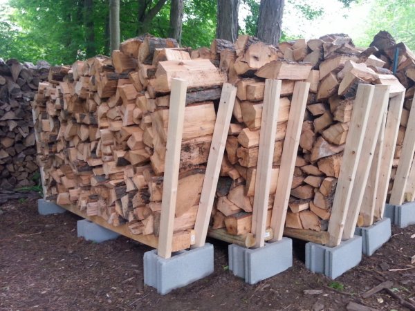

    3 cinder blocks. 1 on each end, and 1 in the middle. You stand 2x4's upright inside the blocks on both ends, and then have 2 runner 2x4's to stack the wood on. You can use shims to tighten up the uprights. As you fill the rack the stacked wood presses out the uprights, which in turn tightens themselves inside the block. Found a pic online... Like this.. [​IMG]

    I've used 4 and 8 foot 2x4 cuz they're pretty cheap and also small pine trees stripped of branches cuz they're even cheaper.
    1/4 cord for each one. 4 side by side in a cube can be tarped easyish.

    That's pretty dang cool! Never seen that before, thanks.

    make sure you're on solid, hard packed ground. Unless of course you want the same lesson I got! :doh:
