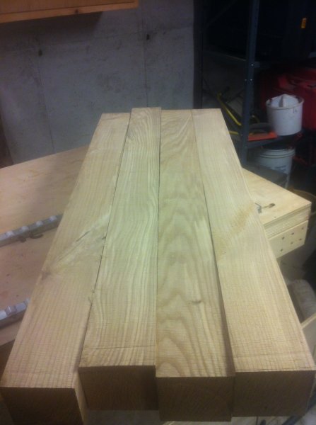

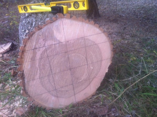

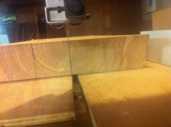

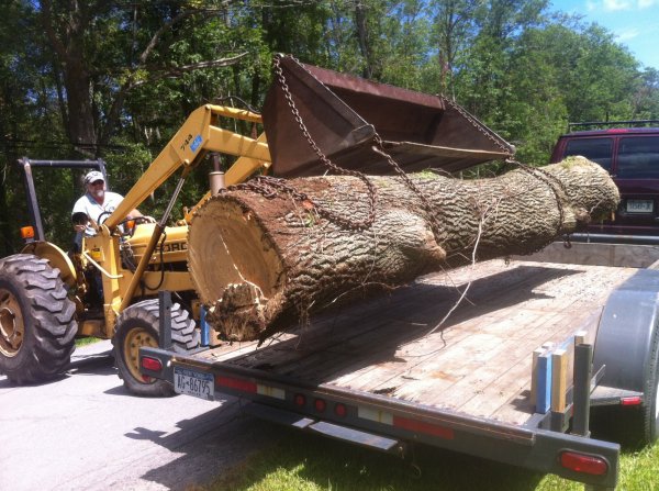

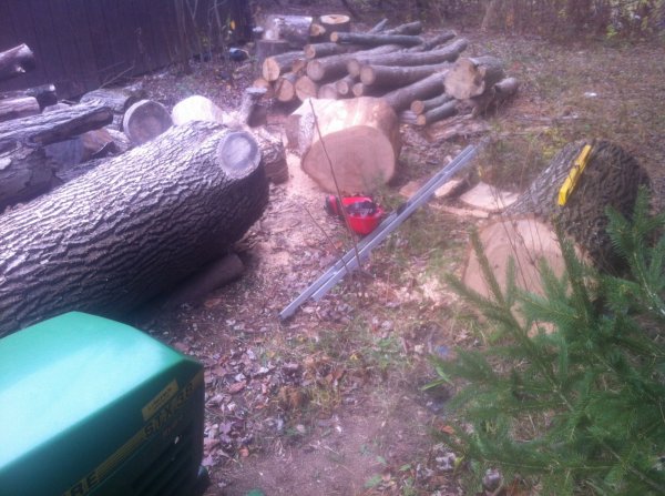

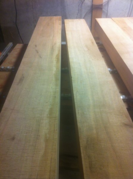

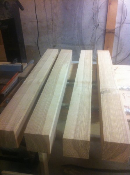

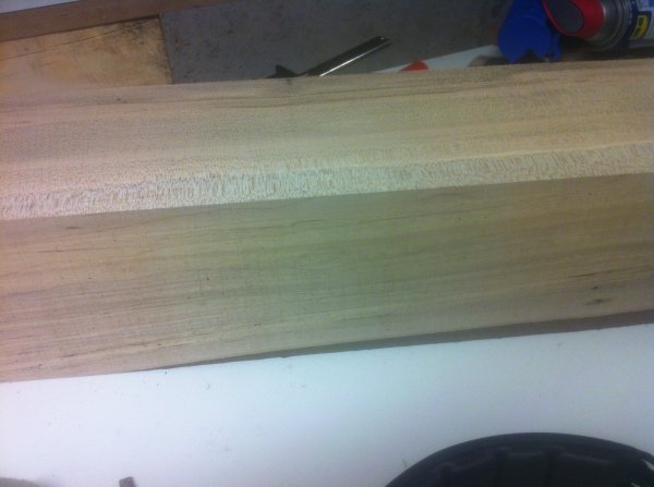

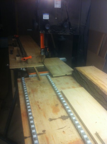

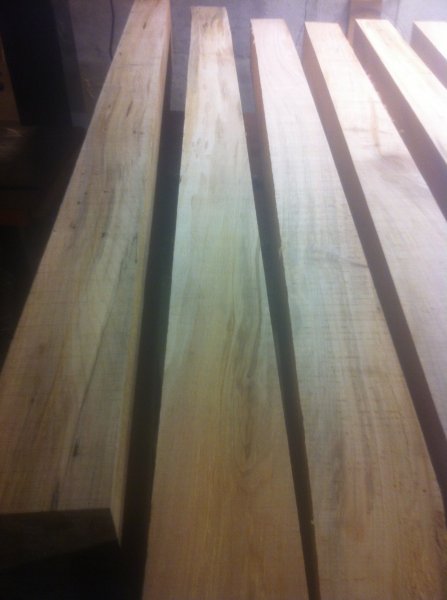

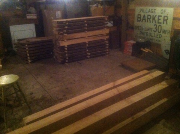

    My neighbor had a massive ash fall down last spring. No EAB damage - just ants. I saved the log and its been sitting in my pile since last summer.
    I finally decided how I wanted to mill it. I'm just going to cut out the 2 clear sections and leave the rest for firewood. I got about a 4' piece out of the top section and worked on that this weekend
    I made 2 live edge slabs 2" thick from the top and bottom slabs, and 2 4" thick slabs out of the center. I resawed those into 8 4x4 on my vertical bandsaw.
    image.jpg image.jpg image.jpg image.jpg image.jpg image.jpg image.jpg image.jpg
    I'm very happy with the way the 4x4s turned out. 4 of them contain sapwood, but have nice vertical grain. Of the center cut ones, 3 of them have face grain on all 4 sides, the other has it on 3.

    Thanks! I'm really just kind of hoarding at this point. :D The dream is to eventually produce some fine furniture from all of it. I sort of consider all of this to be part of my self-teaching apprenticeship. :) I just tried to saw it for what I thought were the best quality pieces I could.
    So, I was thinking the center cuts could yield some really great material for leg stock, and I made those into 4x4s. After planning those out, I saw that I could yield 2 more 2" mostly heart slabs from the outer parts, and I figured the flat sawn grain orientation could make for some nice tops.

    I still can, but they'll have to be 4" wide. :) Lately I like to saw the heart out 2 ways. A lot of the boxed heart pine I made earlier this summer is cracked badly.
    To me, ash is all about the straight grain, so I wanted to go for the 4 side face grain from the center cuts.

    That tractor makes your ash look big!!!!:D
    When I saw the shorter slabs, I was thinking "baseball" bats!!!!

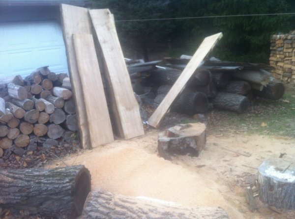

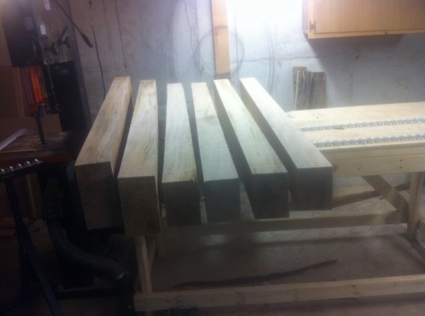

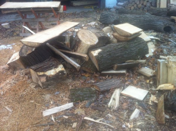

    Day 1 of my wood hoarding vacation - finishing up the hard maple. Part of the reason for working on the ash now was because I also needed the 36" mill, and I could use the same setups to work both logs at the same time.
    There were 3 4" thick, 5'10"L slabs that got similar treatment as the ash. Except with these I tried to leave as much wood as possible. I ended up with 4 6", 1 7", and 1 8".
    Hard Maple Total yield
    3 live edge 8/4 7'3"L 19"Wavg
    1 live edge 12/4 7'3"L 18" W
    1 live edge 8/4 5'10"L 14"W
    4 live edge 8/4 5'L 12"avg W
    6 16/4 5'10"L 6"-8" W
    4 24/4 8'3"L 6"W
    3/4 cord firewood

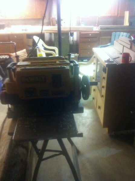

    Shawn Curry, how much surfacing will need to be done on your custom cut lumber? Do you employ a thickness planer, or a jointer/planer?

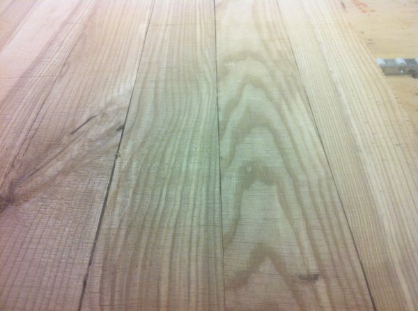

    Western NY

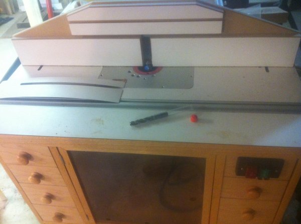

    My cuts have improving with practice, but it will still need some surfacing and squaring. Currently I have a DeWalt 13" thickness planer, and I use my router station for edge jointing. I have a solid carbide spiral bit and a shim for my out feed fence that I made from some laminate leftovers. That setup lets me joint pieces up to 2" thick. But a jointer is the next thing on the list, if I can manage to stop buying chainsaws.
    But for the wide slabs, I won't be able to justify the $40-50 thousand dollar machines capable of handling a 24" wide, 250lb slab. So ill be going old school on those and learning to work them with hand planes. I'm hoping to get a set of old Stanley's for Christmas.

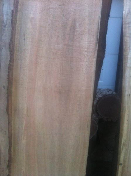

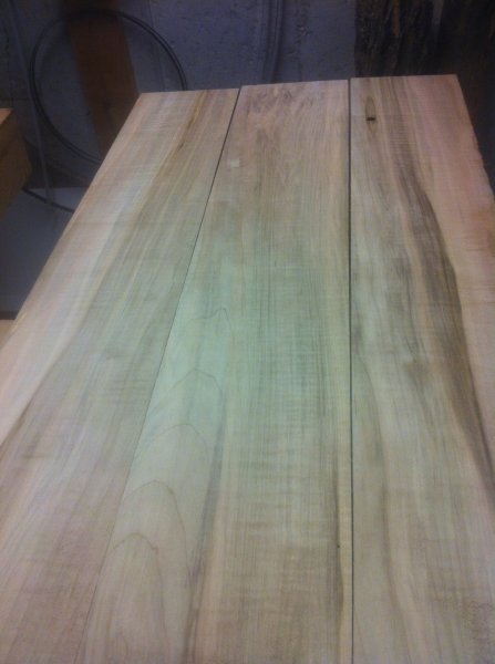

    Here's some rough cut maple fresh off the band saw. It won't take much.

    Wow, I see some nice table legs in all that 16/4 stock! That straight grain! Nice work
