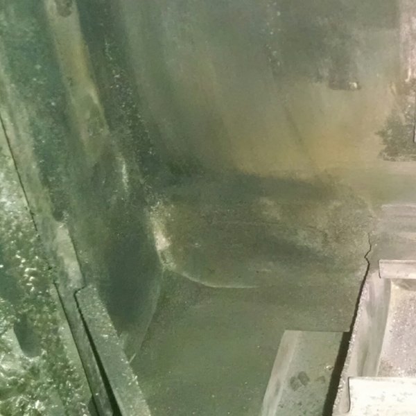

    Ok, what is that oval shape in the left hand upper side of this pic.
  10. badbob
    badbob
    Apr 23, 2014
    2,482
    9,947
    LOL crack in the steel(maybe not lol)
  11. SmokeyTheBear
    SmokeyTheBear
    8,324
    39,419
    Standish, ME
    Air goes through the burn pot ,up through the heat exchanger were it gets split into two halves, one goes right and one goes left then both sides go down behind the firebox join together and head to the combustion blower and from there out the venting.

    Don't think so.

    ok,saw line,now have no idea of what you want me(us) to see.Warp on the plating?

    Weld lines

    Interesting in the shape of a oval race track. Most welders would have trouble with that.

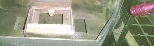

    What are the 2 large openings beside the aperture for the fire pot ??
    Where do these lead to ???
    Do those large openings connect to the same area below the fire pot??
    It would seem that there should be covers over those holes
    If the two openings are connected to the passage that's directly under the pot they can't be left open as the incoming air must pass up through the grate
  18. Steve270y
    Steve270y
    Nov 28, 2016
    21
    83
    Massachusetts
    Deck clean ports... open during the photo. Allows ash to be swept into ash bin below. Closed during operation.

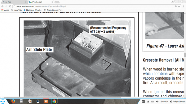

    Here is a piccy of the pot area and shows the "Ash slide plate"
    Does your stove have the slide plate ???
    If not then get two pieces of sheet metal and cover the openings on either side of the grate area.
    The entire volume of air coming into the firebox MUST go up through the grate.
    Does the ash pan have a seal on it when it is closed ??

    Oval is an optical illusion.... little bit of ash making it look oval.
