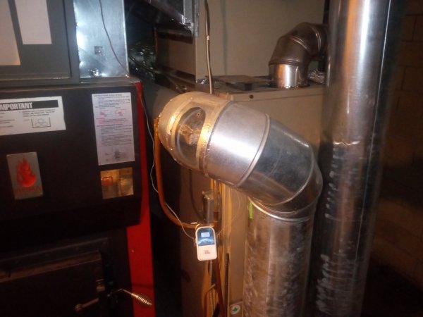

    I put in an Outdoor Air Kit mainly so I could open the primary air up when the high temp main burn is ending and the coaling stage begins. I always felt like opening up the primary air would pull so much more air out of the house and bring cold air into the house elsewhere reducing the efficiency. I also cut 2" pine or poplar cookies and short small splits to load east-west specifically for putting on top of the coals after raking them to the front by the primary intake air box.
    The benefit of the OAK has been somewhat offset by putting in the barometric damper but I had to get that draft from the 33' of double wall chimney down to levels that weren't just eating my wood in an hour and sucking all the heat out the chimney. I can now get 5 hour 400 degree burns that heat the house more effectively and then burn down the coal buildup using techniques like Kevin (Huskihl) mentioned above so I can more quickly get another full load in.
    I'm almost thinking about putting an OAK in to feed the barometric damper to lower the indoor air usage even more, but I'm not sure if that has been tried yet or if there could be bad side effects from that.

    I do burn hot and my chimney seems to have no real creosote build up even with the baro-damper in place. I haven't checked it yet since I started burning this year. I'm waiting till over Christmas break after I've run at least a cord through it and a little warm snap to run the brush up the chimney and ensure there isn't any build up at the coolest part at the top. I don't notice any lack of draft like what Scotty had reported due to his spark arrestor screen starting to clog. I have adjusted the baro to the most open point of it's adjustment and my draft still measures -.09" or so and the stove manual recommends a minimum of -.05". I've been running it there for about half a cord of Ash and Honey Locust with a bit of Sugar Maple and Bitter Hickory mixed in, all well under 20% MC. I won't do anything till I get a good read on the chimney.
    brenndatomu ,
    Is the OAK for your Baro direct coupled and sealed or loosely coupled with an air gap? Got any pix of your install?
    I have a 5" wall penetration near the stove that isn't being used and I'm thinking of coupling that up to 8" pipe to go over the 6" Baro and seal it in with metal duct tape over the pipe just behind the mechanics to make sure the flapper isn't disturbed at all. You had mentioned in another thread that the Field Controls brand is way better than the cheapo ones I saw at some of the big box stores locally. I could get those to hang up but the Field's one works velvety smooth. All the professional installations I've seen on many furnaces I've been around have good quality smooth operating Barometric dampers.

  12. brenndatomu
    25,352
    165,126
    Kinda both...I have an 8" pipe that I slid over the 6" baro...then some duct wrap/insulation loosely filling the gap. That way it allows a little makeup air for the furnace if it needs it, but not a huge cold air leak dumping in the basement.
    My pipe comes in from outside at ceiling height, then drops to the floor before turning back up to connect to the baro...makes a place for the cold air to settle in, unless "pulled" in...cold air trap I guess.
    I have to get some pics...here ya go, I was down for the morning load anyways.
    You can see where I cut a window into the elbow so I can keep an eye on things...the "glass" is an old 2 liter bottle. IMG_20251210_065855852.jpg

  13. MAF143
    MAF143
    Dec 8, 2018
    1,732
    12,232
    North Central OH
    I like the improvised "lexan" viewing window... Visual confirmation of proper operation is always comforting.
