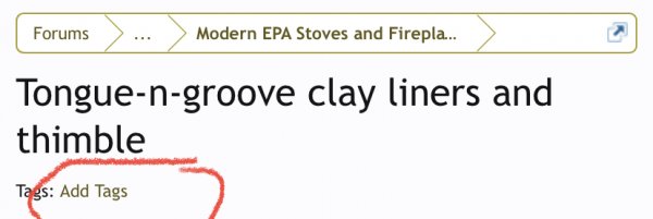

    You can increase your chances by adding tags…

    :rofl: :lol: I’m lucky to post a link.

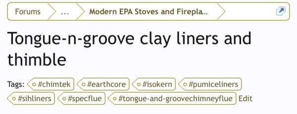

  16. Eric VW
    23,607
    133,427
    Added. LMK if you think of more…

    I just got schooled. LOL!! That’s pretty sweet.
