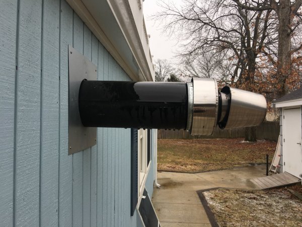

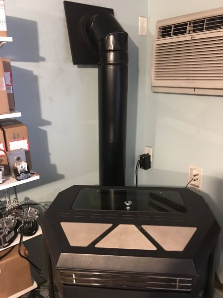

    Started the install plans for the Allure. I figured since it's not that cold out I would take some extra time and completely redo the corner that the stove is going in. 2 yrs ago over the winter we redone the stove room but worked around the stove so that will get finished now. The Ravelli sits on a raised hearth on top of the carpet so that's getting changed. Picked up the vent for the Allure oak since that needs to be changed to 3". If it ever stops raining I will go pickup the sheet of paneling i'm gonna need for the back and side wall. I'm figuring 2 solid days of work until the stove will be ready to fire but it should look nicer then it currently does. Here is the vent I got for the oak with a 4" - 3" reducer Shop IMPERIAL 4-in Dia Galvanized Steel R2 Exhaust Dryer Vent Hood at Lowes.com I removed the damper and installed a piece of screen. The vent will pass through the wall and then flex pipe too the stove. My goal is to have everything on hand so that when I tear in I can get it done in the projected 2 days. :whistle:

    I'M reusing my current 3" duravent I just have to move the pipe over 6". I think I could have just used an adjustable 90 and made it work but I don't want anymore elbows then absolutely necessary. So the exhaust will come off the stove straight out and up 5ft. Only about 6" of pipe will be inside. My existing oak is 2" so I have to change that. At some point I may invest in the Harman wireless sensor but for now I'm gonna try putting the wired sensor where I have the Ravelli sensor and see how accurate it is. The Ravelli is within 1 deg. Of my thermometer in the next room.
