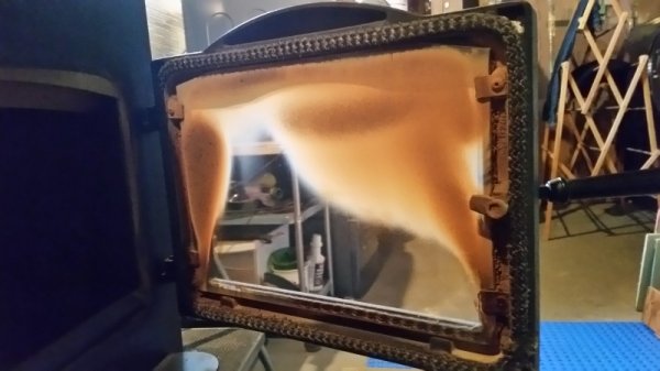

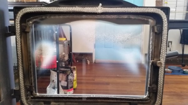

  19. bogieb
    12,606
    76,675
    I have the same experience with the glass in my stoves. My P43, regardless of what I burn in it stays pretty clean. The P61a gets dirty much quicker and with a brown-reddish ash. Here are pics after 2 weeks since the last cleaning. Granted, the P61a is burning worse pellets, but the P43 isn't by any means fed a top pellet either. Also, the P61a runs more than the P43. The P61a will get a lot dirtier sooner, but the pattern, once established, stays pretty much the same until I clean it.
