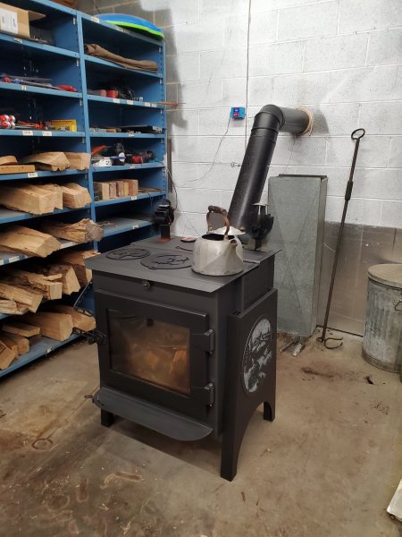

    I have a probe in my flue pipe where it enters the wall about 4 feet from my ideal steel. If I wait till it reads 350 before closing the bypass, the temp drop and recovery take 2-5 min. If I close it even 15 degrees cooler it may take 10 min or more to recover to the same temperature. I believe you'd probably need a probe and not a surface reading to get a quick enough response time for my process to work.
    With an EGT probe, try different temperatures to close the bypass and time how long it takes the temperature to recover. If it's more than 5 min, try a bit hotter. That's what I've done and I'm comfortable enough with the results to let someone else run the stove if needed. I can reload on a bed of coals and be at set and forget in under 30 min, less if the coals are extra hot.

    The exhaust gas temps/flue temps.... Do they have to be taken in a certain spot, or area? Ie, must be within 24 inches from exiting the stove, etc....
    Most of the vertical is two pieces...a 12 inch and an adjustable. Could I go up to the vertical piece of that 45 elbow, and put a probe there? Just thinking about taking pipe apart, and lining back up for the probe hole .....

    Really shouldn't matter. Will just get more differential the further you are from the stove. Mine is about 2" from the wall, about 4 feet from the stove. The closer you are to the stove, the higher the readings. You can see the wire hanging against the wall in my attached pic.

    Does that wire go to the blue box? What is that fancy shindig?

    Being in the basement I don't have much care for what it looks like. The probes I've been using and like are these:
    3M K-Type Thermocouple 100mm Sensor Probe Temperature From -100°C to 1250°C https://a.co/d/c1oViKS
    The display is one of these. I have its probe installed in the same pipe and it reads almost 100 degrees cooler than the long one in the middle of the stream.
    PEMENOL 12V Red Fahrenheit Digital Temperature Meter -76F~999F LED Display with Industrial Grade 0.5m K-Type Thermocouple Temperature Sensor M6 https://a.co/d/54gDqFV
    I actually have the 3m probes connected to a data logger I can access across the network. Back when I was running a non-epa stove I'd check it to make sure my flue temps were over 400 going into the wall. Now I commonly see flue temps about 100 degrees under STT when the Ideal Steel is cruising. I've been debating on replacing my cat probe with one but I don't want to deal with a wire over the door.

    Manual states temp sensor is supposed to be 8 to 10 inches above flue collar on top vented stove,if rear vented place surface thermometer on plate in back of stove.
    Internal temp sensor for flue woud be placed in same location.
