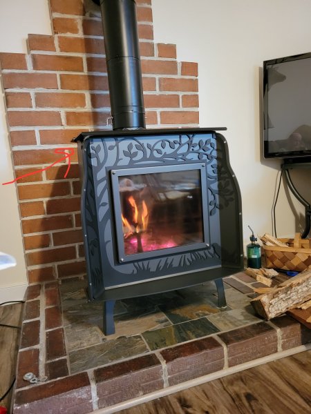

    Well, I won't even say how long it's been since I got this stove, and how long it's taken... Some of you know. Thanks for all the help in the open forums and pm's...
    Finally got the pipe finished this am.

    Purdy vines on the front.
    Best of luck and enjoy it!

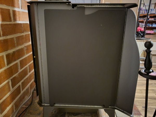

    If any AS owners stumble by....where does the cat probe go? I don't see a hole for it anywhere....
    I'm not at the house right now to look in the book. And I don't remember seeing that in there when I read it (totally could have missed it though...).

    Great lookin' stove! Nice job w/ the install. Time to sit back and enjoy the fruits.

    Hey that looks good!
    Is it keeping yall warm?

    The probe goes in on your left side (opposite the loading door) about 2 inches down from the top plate. There is most likely a bolt there now that you need to take out in order to insert the probe. Then it goes through a small hole in the "hood scoop". to be in front and slightly above the cat output. The probe should have an 8-inch shaft from the rear of the gauge. There is a magnet with a hole in the center that you use on the outside of the stove to pull the gauge tight against the hole. When you lift the top plate to see the hood scoop it will become obvious.
    I hope this helps.
    Steve aka oldhippie. I have an AS and hope you enjoy it. Let us know with any questions, there is a learning curve.
    Congrats on a beautiful stove and installation.

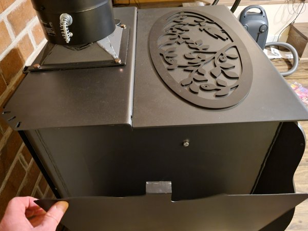

    There should be a bolt on the side to remove and install cat probe. 3C120A82-3054-4336-B5E7-C476A014F67B.jpeg

    Look what's behind the sheild.....
    No hole in the shield... So, I'm supposed to drill it? Surprised they didn't make the hole.

    Ah, the other issue there, beyond drilling the shield, is the length of the probe. I think that there are 10 inch probes. So the current probe might not be the right length. Did you buy the probe through Woodstock? I'm thinking they send you a new shield with a hole for the probe and the right size probe. At least we got to the bottom of this head-scratcher.

    Probe came with the stove. And obviously the shield..... That's why I'm surprised it wasn't drilled.

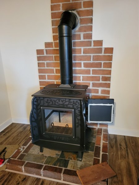

    It really is a beauty, I'm a bit jealous of the nice looks it has. The double brick platform it's on is very nice too. Having nice aged wood is going to be very helpful for you. Once you start building bigger fires you will get lots of nice light shows to go with a warm cozy home.

    That's a great looking stove. Clean install too! Looks like you took your time and did it right.;):yes:
