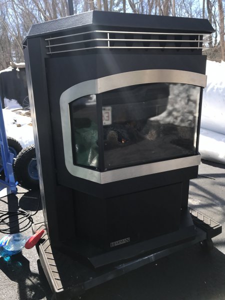

    Looks Great :cheers:

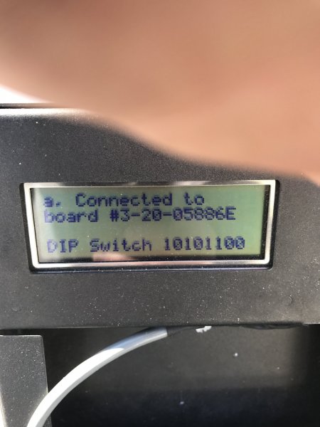

    Can anyone just confirm that these are The correct dip switch settings. Red ESP

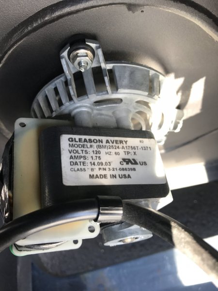

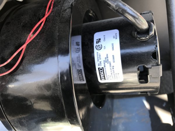

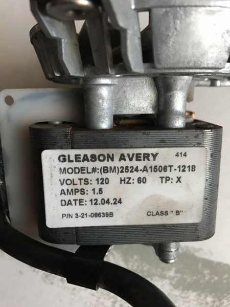

    Hers s pic of both blowers. 1st one is from New stove and is 1.75 amps 2nd is of my spare which Is out of a p68 but it's only 1.5 amps. Should I use or just get z new one

    Looks like you got a Great stove at an awesome price :thumbs:

    It looks real nice, clean as a whistle. Nice job, hope she burns as good as she looks.

    If it was me I wouldn't worry too much about the exhaust motor. You can try to lubricate it but there's no oil ports. I would use anti-seize on the shaft/fan blade if the need arises for a replacement.

    Noise is to loud to ignore. Sounds a little better with blower removed from the stove and running on a test cord but definitely louder when installed and stove running. I did hit it with a couple drops of 3/1 oil and let it sit for a few hours but no improvement

    the dip switch settings look fine for a red probe, which yours should be if its 2014.

    check the fins and make sure they aren't bent a bit...otherwise, just change it out....not going to get quieter.

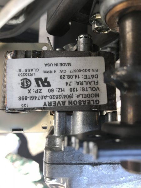

    the feed motor you want is 3-20-00677, so, your image above, img_0592.jpg is correct.
    The combustion motor and impeller are the same on the P68 and the Advance.

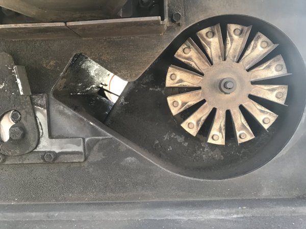

    My new acquired furnace did the same, exhaust fan seems louder when not connected to a vent. I took it out to verify it just like you with lamp cord, much quieter. Might just need to be connected to a vent, who knows. LW says to check the fan blades which is another culprit and yours looks like a double paddle type so odds for it to be out of wack is slim. Trying another motor can do no wrong except having a spare or a noisy spare. If you have the 1.5A motor, try it. Clean the blades good which I would think you did already.

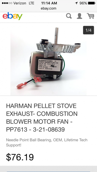

    I'm just gonna replace it now. How's this one on eBay from esesstoves

    Looks good. I have bought stove parts from them in the past (on and off eBay). Good experience and prices, would buy from them again.

    For what it's worth, I bought a Gleason last year for my Quad (by chance from esesstoves too...good people) , it was somewhat "loud" from day one. Just bought and installed this week (yesterday) a Fasco off Ebay.....whisper quiet.
