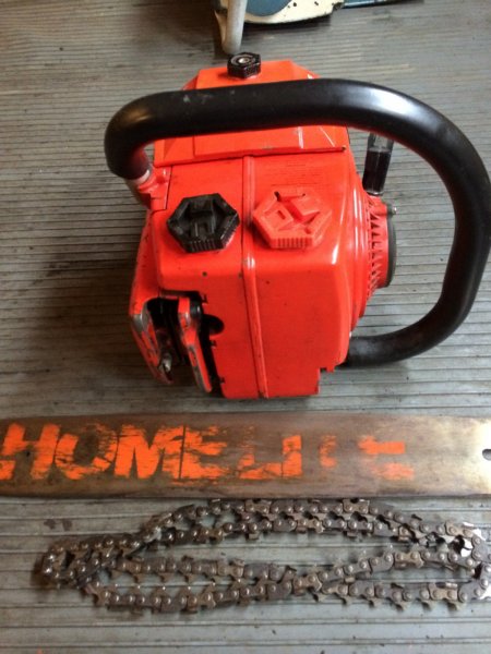

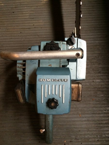

    The Homelite 410 cleaned up okay, but is missing some paint on the rear handle and clutch cover. Inside it was a lot cleaner than the outside would indicate.
    I found a bunch of small issues, loose screws, unhooked throttle linkage, fuel lines pulled off the carb, etc. It ran on prime but didn't want to pull fuel.

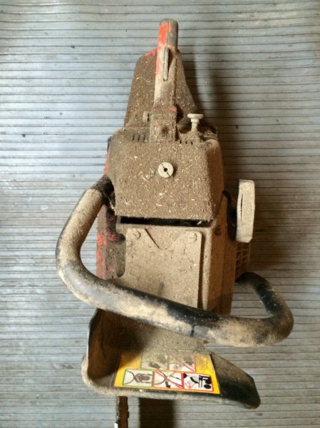

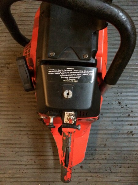

    It appears that saw is a Farmsaw II SHW (S = safety chainbrake, H = half wrap handle, W = Western). The Western feature apparently featured a 3 shoe steel clutch and floating rim sprocket). Seems this may be a rather uncommon saw.

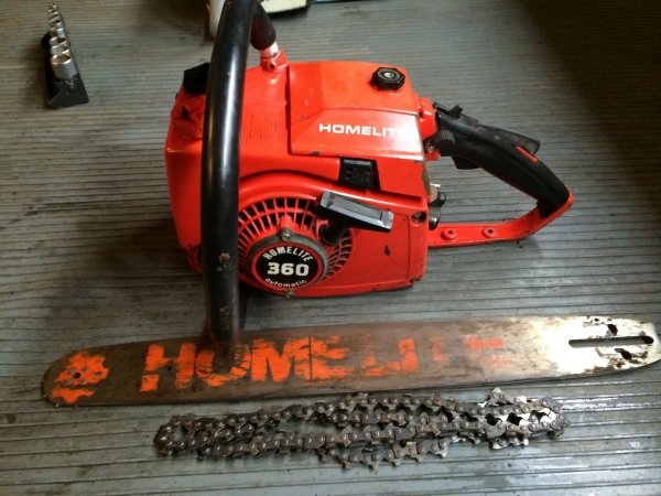

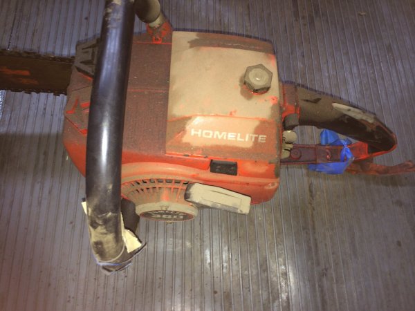

    Next up is the Homelite 360. Was dirty like the others...

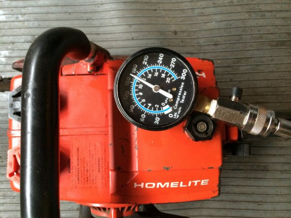

    The good news is that it has 170 pounds of compression.
    Cleaned it up a bit:
    It fired up and pulled fuel but there was no throttle response. I pushed the choke off and it raced, choke on and it idled back. Shut it off and found the throttle is stuck wide open, apparently there is an issue with the spring. I can pull the throttle down but when I squeeze it there is no return.

    Put the gauge on the Pioneer Farmsaw II and it didn't quite make it to 110. I think I will try the Pioneer P-28 next.

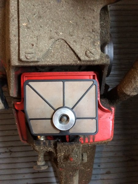

    The P-28 S runs on prime but needs some help... The chain was off the bar and when I took off the clutch cover I found no rim or clutch drum... The muffler is also loose and missing the two screws at the exhaust port. On the bright side the AF cover is intact and in 1 piece, which is unusual. This one will be listed shortly for sale.
