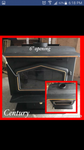

    This is the Century 2700 I'm trying to find more info on.
