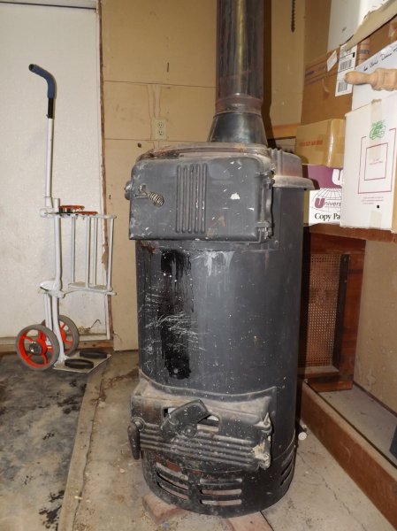

    does this look like a coal or wood stove?

    I don't know It's beyond my experience. Inside is there a very heavy duty set of grates with a shaker?

    If it is an open grate at the bottom, then IMO it is able to burn coal. If it is covered at the bottom it is solely a wood stove. If it has a detachable grate you have the option of both.

    I'm betting that stove is a wood/coal stove. It looks very close to one my parents had. There should be a shaker that you hook onto the grates and move back and forth to shake the ashes down to the bottom. That type should also have a damper in the flue. But what puzzles me is there is not another draft in the firebox door. Usually it is a slider. But, if you look for the bottom and see grates that you can move to shake the ashes down, it will burn coal.
