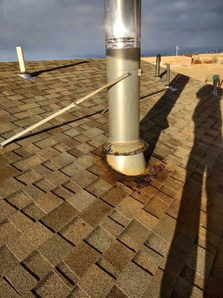

    Check on your neighbors Hoarders. Some might recall a family we know from kid's school and we buy beef from lost their home, and their husband and father perished from a chimney fire. WWW was called to a roof across from the ranch that burned down that he'd done several years ago, that woman's husband sadly had passed since and the widow said she had "something" leaking from her roof by the wood stove pipe. This older woman had creosote oozing from the pipe & spark arrestor, so much it was dripping off and melting the shingles it fell on below. (pic does not reflect the amount of creosote that was really there). She knew about the fire across the way as well as knew her husband and WWW had done commercial business together, she promised him she would not burn it again til her son could come clean it, and listened and understood WWW explaining what seasoned wood is and how dangerous wet wood is. Point made, she just lost a neighbor this Oct. and she likely got lucky with a chimney fire that boiled raw liquid creosote over.​

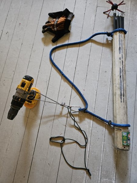

    Finally cleaned my chimney.
    A thin layer of black powdery stuff came out and up.
    Will pull the stove pipe, clean and vaccuumm all that out tomorrow. But the hard part is done!

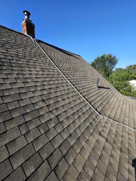

    I made a new setup for hauling the sweep, drill paracord up there. The green paracord loop and beaner are for clipping and hanging the top piece off the chimney while I clean down. The tube is an old piece of down spout, the blue rope screwed on from the inside. The peanut butter jar is screwed on from the outside. All self tapping screws.
    Rope i leave up there for easier access.

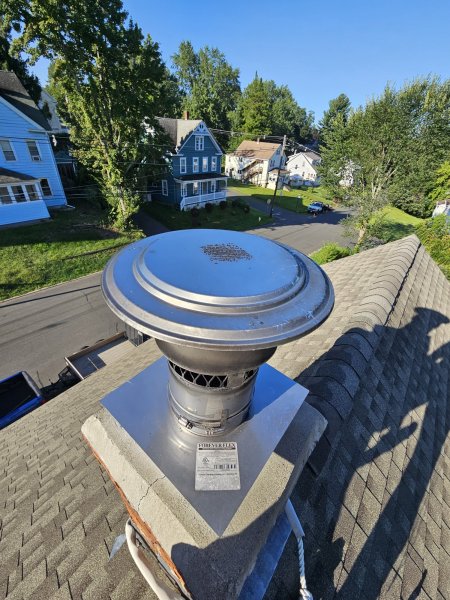

    View from the top.
    Tools rig.

    Keep an eye on that crack. Freeze/thaw will make it bigger.

    Willdo. That was there last year. Mebbe I'll find some sealer and get it on there.
    Thanks for the heads-up.
