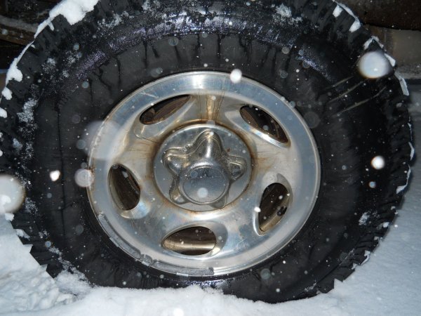

    And today brings a whole new aspect on the treadwright saga! I thought I had picked up a stud from a snowmoblile in one of the brand new retreads and left the truck at a local shop to have the "leaky tire" fixed while I was working today. Picked up the truck and the fella said that where the tread is bonded onto the sidewall (of the leaky tire), there are soft spots and air leaks where one can actually press a finger into the side and feel the mushy bond. I suspect that there were some air pockets there. At any rate, I spoke with the factory and started a warranty claim for that specific tire. By the way, it is the one with all the weights...6.5 oz on the inside and 6.5 oz on the outside...about 11" of lead on each side of the tire!
    Being that the tread is soft and spongy at the point of bonding to the sidewall, I'm thinking that this might also be the tire that is making the "flopping" or "wapping" sound.
    The next step is to wait for treadwright to contact me on what action they will take for resolving this issue. Stay tuned for a first hand review of their warranty procedure! treadwright claim 007.JPG treadwright claim 002.JPG
    First pic is of the weights, second is of faulty area. Spongy area is near the lugs of tread.
    Third pic- begining with this lug, the next 3-4 are spongy/hollow.
