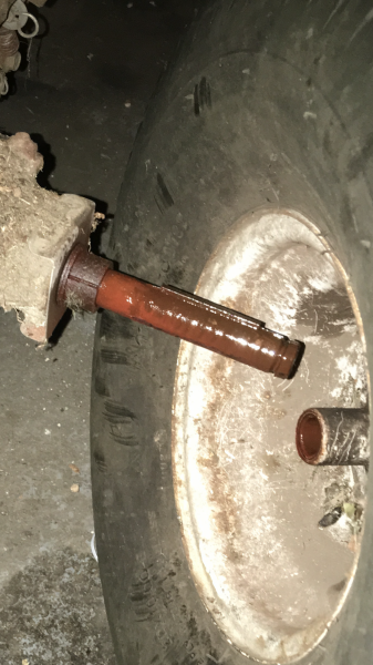

    I decided to pull the wheels and get some tubes!

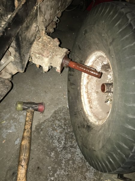

    The small wheels in the front comes off easily, but the large tires in the back due to the key way are stuck!
    So, I jacked the tractor and turned the large wheel until the key way faces up and sprayed the rust penetrant in there 2 or 3 times in 2 Days.
    Then using the rubber hammer just banged the tire off by whacking it on the inside!

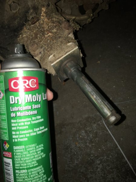

    Yes, I wiped off the rust penatrant, wire wheeled it and then used some CRC Dry Moly :)
