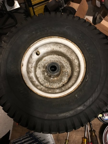

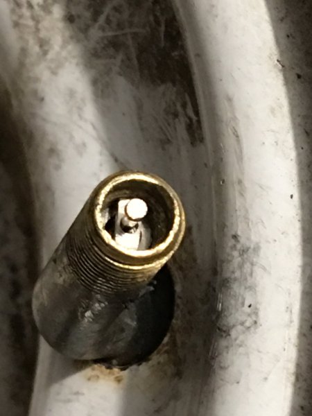

  15. don2222
    don2222
    Nov 10, 2013
    3,438
    4,874
    Salem NH

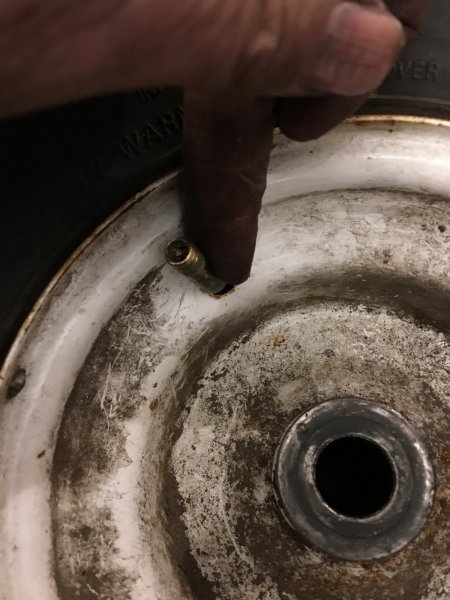

    Had a chance to take the tire off. Bead looks good. Could it be the tube or valve stem?
    See pics
  16. JWinIndiana
    JWinIndiana
    Aug 17, 2017
    1,439
    8,765
    NorthWest Indiana
    If it has an actual tube in it and it is going down (leaking) it is the tube. Inspect the inside of the tire extremely well to insure there isn't anything punctured through. Best bet, you have it torn all down, put in a new tube.
  17. The Wood Wolverine
    18,826
    121,143
    Those valve stems are easy to change and cheap. Well worth swapping it out to find out if it's the culprit.
  18. JWinIndiana
    JWinIndiana
    Aug 17, 2017
    1,439
    8,765
    NorthWest Indiana
    If it is a tube then it would be a valve core. If it isn't a tube, looks like you have the valve stem out, once out, throw them away and put in a new one. Nothing more frustrating than a flat tire everytime you want to use something.

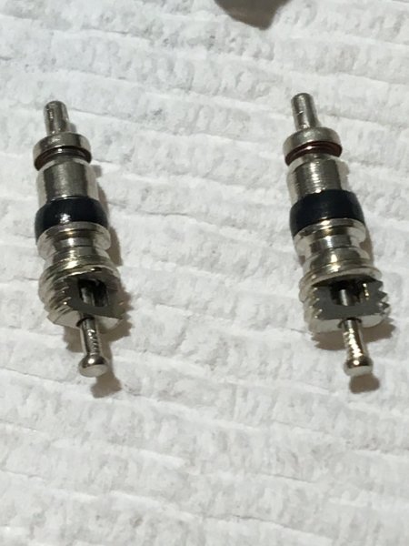

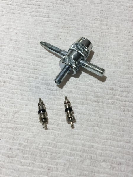

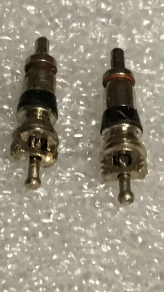

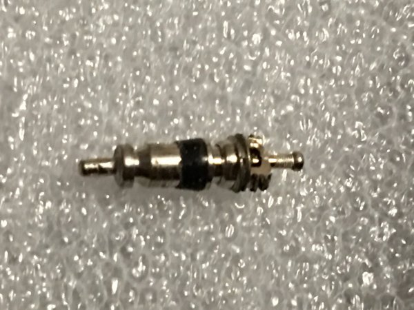

  19. don2222
    don2222
    Nov 10, 2013
    3,438
    4,874
    Salem NH

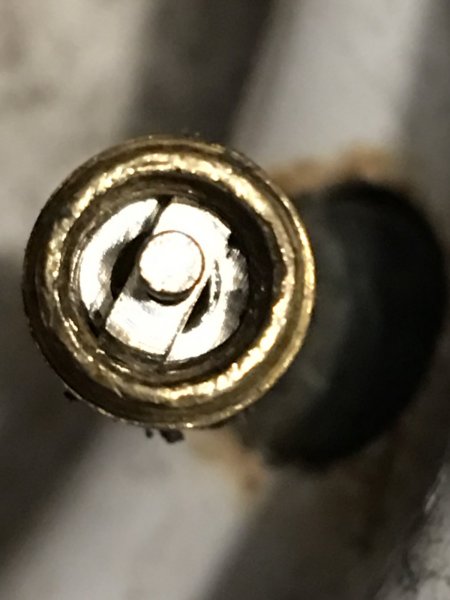

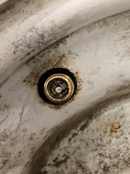

    Hello
    https://www.walmart.com/ip/Slime-4-Way-Tool-with-Valve-Cores-20262/45791090
    I picked up these 4 valve cores and the removal tool at Walmart for a whopping $1.84 and replaced the 2 cores on the 2 leaky tires, on front and one back on the right side. Then inflated.
    The seal on the old valve cores seamed good because even though the tires were flat the bead was good and I could hear some air come out!
    Does this mean the tube is good and the valve core is bad??
    Pic 1 - new cores and tool
    Pic 2 - old core
    Pic 3 & 4 - New core
    Pic 5 - The two old valve cores that were replaced. The springs seamed good and springey. Time will tell. How do they look???
    Pic 6-7 two good cores for comparison
