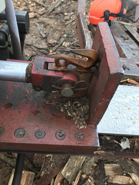

    1-welded a hook on the back side of the ram, every once in a while I’ll get a piece of wood stuck on the wedge.. not so much any more because I got a higher horse power motor.. but if it does happen I hook a chain to the hook and than around the wood. Than simply pull the ram back.. it pulls the wood off the wedge.

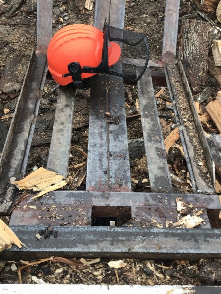

    3- welded angle iron on my hydraulic arm so on the wet frosty morning, when I’m loading the arm the chunks of wood arnt sliding off and i have to pick them up again..
