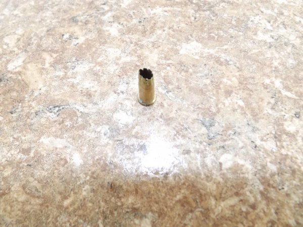

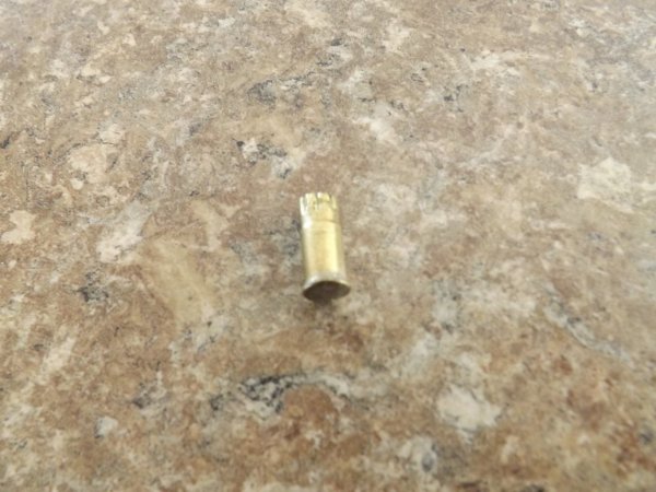

  4. wildwest
    30,771
    145,423
    This showed up yesterday from a corner in foyer,....
    FarmHand78 likes this.
  5. FarmHand78
    FarmHand78
    Jan 10, 2015
    720
    2,895
    South East Iowa
    Yep, that's from a power nailer... word of advise, don't hit one of the blanks with a hammer after a misfire... loud, very loud.
