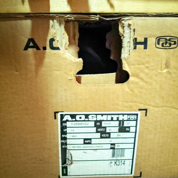

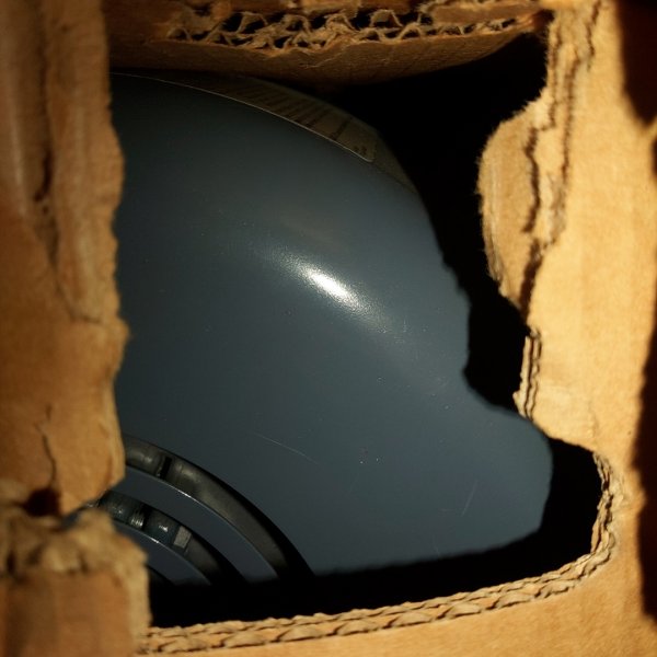

    IMG_20250506_175044_(1080_x_1080_pixel).jpg IMG_20250506_175100_(1080_x_1080_pixel).jpg
    Thinking of using this as the electric drive.
  7. brenndatomu
    25,349
    165,085
    Nice!
    I think that should pull a 22 GPM pump for sure, 28 might be pushing the limit?
    My 16 GPM pump was a bit too much for my "5hp air compressor special" motor (actually more like 4 HP, 230V 1PH 16 FLA) so I had to adjust relief and hi/lo shiftpoints down on the pump a bit, but it still splits about anything I throw at it. I do have a true 5 HP (21 FLA) motor to put on it now though, so that should allow me to go back to higher pressures.
    I can't (shouldn't) go to full 3000psi relief as my hoses are only rated for something like 2800 working pressure, I had my neighbor make them up for me and we had a barter arrangement, so couldn't beat that, even though I would have liked 3000 psi lines.

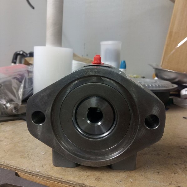

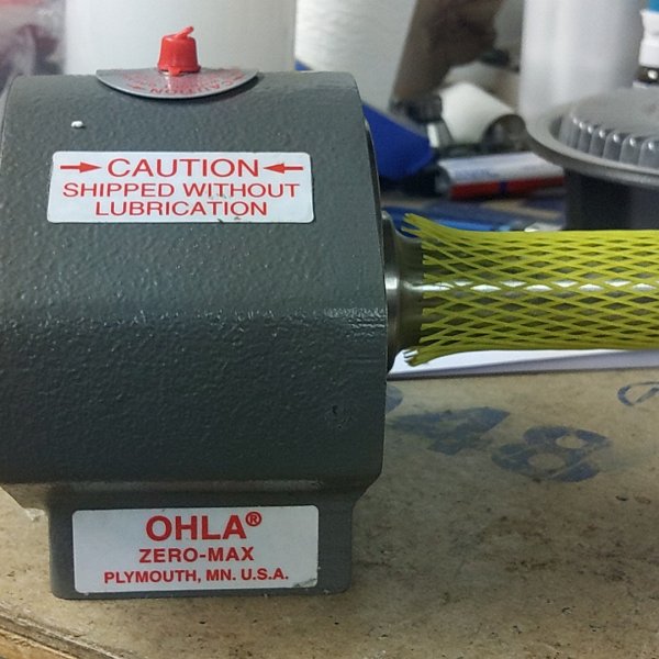

    A hint of my direction...... IMG_20250507_164814_(1080_x_1080_pixel).jpg IMG_20250507_164952_(1080_x_1080_pixel).jpg

    Soooo you may have guessed by now that I'm belt driving the pump with a overhung load adapter. I'm using a 6.9" 3 groove 3V driven pulley that I had. So simply using 3450 rpm disregarding pump efficiency I'm figuring 4 1/2" driver at 18gpm, 5" at 20 .....
    I want to be able to swap hp and ram speed along with electric or engine driver type. A long banded belt could let me hit and miss it. That would be cool at an engine show....... When my grandson is old enough I can make it crawl.
    Off topic... sorry
    Based on your experience, with not adjusting the relief do you think 20 is pushing it?

  14. brenndatomu
    25,349
    165,085
    Oh yeah, if you slow it down a little you are good to go with a 7.5 HP electric motor...myself I wouldn't want to cut it in half, which with the pulley sizes you listed that would put your pump at 2283 rpm with motor at 3500, which should put you in the 18gpm range with a 28gpm rated pump. That would make your 5" x 20" (if I read that right) run a 10.5 second cycle time (assuming 2"ram)
