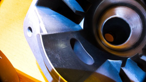

    For the curious, here's the intake side of the cleaned up cylinder in the merciless glare of my LED reading light, with the contrast amped up to make the detail stand out. I didn't bother with an exhaust-side pic because it cleaned up perfectly.
    I'm not sure what to make of this sort of broad scuffing, but if there's a smoking gun here I can't see it.

    If you can't feel anything with a finger nail then it's probably just discoloring.

    Even if they are areas where the plating has been damaged, which is likely, micro spots like that low in the cylinder will not kill the engine. If it's sanded smooth, the ring is likely to just ride over top of the imperfections without any significant detriment to the remaining life of the cylinder.
    If I were keeping the saw or just wanted to run it awhile, I would run that cylinder. If it was getting sold for sure, I think making it a 7900 or the BB kit would be worth the piece of mind considering he's into the saw for peanuts at this point.

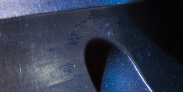

    It's a little more than discoloration, but not much. I can't feel anything with a fingernail, but there are 2 or 3 spots where I can feel a bit of a catch or roughness by dragging the corner of a steel ruler across. The whole intake port is only half an inch high, so we're talking about a line that's maybe a quarter of an inch long, and a rough patch that's about an eighth of an inch across.

    Unless you have any intention of keeping this saw, and as good as the jug cleaned up, I'd be very tempted to put in a new piston and send it down the road for a nice profit. Heck, even if you do plan on keeping it, I would run with that jug for a while...you could always sell it later if you wanted to go big bore down the road.

    Those small imperfections will fill with carbon over time. I wouldn't worry about it.
    I used this cylinder and was told by several members that those lines are insignificant and will fill with carbon over time.
    No worries. Get a good piston kit (Meteor w/ Caber rings) and run it ;)
