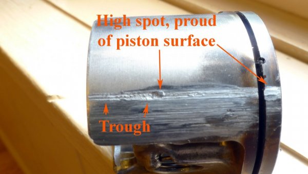

    Even a lean seize caused by a leaking impulse line should have had all the damage on the exhaust side. Crazy how yours is all on the intake side.

    This is a stretch, but if a piston was a bit out of spec, and was run hard from cold, could the dis proportionate heating of the aluminum "out of round" piston start a hard rub snowball effect?? The lean condition only exasorbating the problem??

    It looks like there is a small chip missing above the piston ring to the right of the centering pin.
    Could have been one where the transfer occurred as well

    I'm thinking that because the impulse comes in high and inside the transfer port, the fresh air is confined to that one channel and blows into the combustion area at the end of the burn, overheating just the local area where it emerges into the combustion area rather than mixing evenly into the mixture in the crankcase.

    That gouge just looks like it was dug out. I've only seen just over a half dozen lean seized saws, and they all had "build up" on the piston. None were gouged "inwards" into the piston. ..
    I have 2 or 3 examples at home. I will take pics later

    Looking at those pics on the computer, it does in fact look like the saw ate something. Big gouge on the skirt of the piston, lower right, intake side.

    Sounds like it's time to push my camera's macro settings a bit further... 6401 piston damage.jpg
    There's actually both buildup on the piston AND a gouged area, but the gouge looks like nothing so much as the path left behind when you're rolling up a big ball of snow to make a snowman. The bottom of the trough is rough and choppy, not cleanly cut or smeared like other areas. The trough also starts out very small at the bottom of the piston, and gets wider and deeper as it goes up, terminating in a flattened bump that's raised above the original piston surface and above the surrounding damaged area as well. This line crosses the intake port, and there are no nicks whatsoever in the intersecting top or bottom edges of the port to imply an object hitting them.
    Above the flattened lump of displaced material at the top of the large trough is another, much smaller trough, and the material from that appears to jumped over the ring and been deposited as another lump at the top edge of the piston.

    Looks to me like it ate a small piece of debris and gouged the slug, nicking the ring. Now you have a hot gas leak past the ring which would create extra heat on the intake side, and plausibly enough so to leave smearing/transfer which of course gets exacerbated by the now poor fit of the piston in its bore.
    But that is just a wild azz guess. :)

    Nice, but I looked at the ring with an 8x loupe and there are no such nicks in it. The surface is scuffed in a narrow area and there's one shiny spot of aluminum stuck to it, but no grooves going across. It's actually in pretty nice shape.

    Could the Item that caused the damage have been harder than aluminum, but softer than ductile cast iron?

    How does the cylinder look in that area? Any gouges?

    Plug looks good - a little carbon at the end of the threads where it emerges into the combustion chamber, clean insulator, brownish at the tips of the electrodes. No chunks missing. No scratches at all that I can see on the cylinder wall, just burnished areas and varying amounts of aluminum transfer. One thing, and maybe this is normal, is that most of the transferred aluminum is in a really thin layer, as if it just a few molecules' thickness rubbed off, but then distributed randomly over that area are small clumps of thicker stuff, as if this was the school desk under which students had been discarding unwanted aluminum chewing gum. I've never looked so closely at top end damage, so maybe this is typical.
