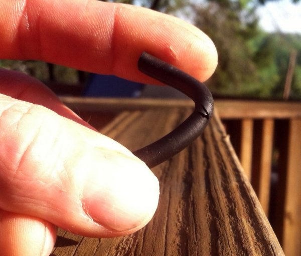

  19. Jon1270
    Jon1270
    1,886
    4,543
    Pittsburgh, PA
    Well, it seems that confirmation bias led me astray. This morning I put a couple of teaspoons of the fuel onto the clean bottom of a tomato can, and used a low heat gun setting to evaporate the fuel. It did leave behind a light oily residue, dealing a nasty blow to my straight-gassing theory.
    Following up on Hedgerow's observation that the worst of the transfer was localized rather than spread across the whole intake port area, I figured I'd look for nearby problems. Could there have been a leak on one side of the intake boot? No, the boot was in excellent shape, soft and supple. Could it have been adjusted too lean? Nope, the high-speed limiter is intact and set near the rich end of its range. What else is near there? Well, the impulse line comes in on the damaged side... holy, what the...!?
    That isn't even all of the damage. The impulse line is riddled with cracks, both longitudinal and transverse. It's practically falling apart.
    Now I'm mostly wondering, how the heck does this lousy impulse hose end up on this particular saw?
