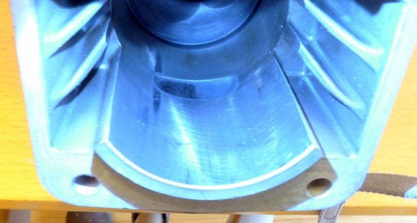

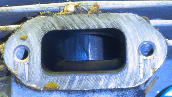

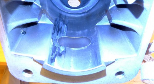

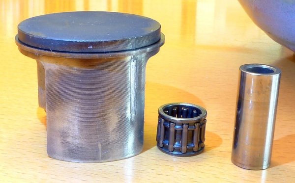

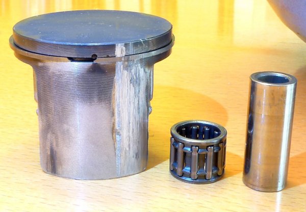

    Here you go. No obvious bearing failures or debris in the case.
    Here's what was in the gas tank:
    Intake:
    Exhaust:
    Interesting case, eh?
    raybonz likes this.

    Looks like it swallowed something? Maybe a throttle plate screw or a piece of spring

    Haven't found anything yet. Contrary to MM's prediction, there's a lot of aluminum transfer on the intake side, and just a little next to the exhaust. Not much in the way of scratches.
  15. lukem
    12,337
    67,128
    Any bits and pieces / shavings down in the crankcase? Did you clean that piston up any? It looks VERY clean. I'm far from an expert on this with 2 stroke engines, but something went very wrong very quick...almost like a foreign object was in there...but I'd expect to see some scratching too if it wedged in there. Dunno. :confused:

    I wiped off the oil with a paper towel so I could see the surfaces better, but that's it. I haven't found a single bit of debris in the engine, and I can't see any scoring to speak of inside the cylinder either.
    I've just looked at several photographic piston diagnosis articles / charts, and the best matches for aluminum transfer on the intake side and/or both intake and exhaust sides all indicate lack of lubrication. They also say such failures are quite rare.

    If you had oil to wipe off, then there would be at leas some lubrication present, no? What about the wrist pin and crank bearings? They oily?
  20. Jon1270
    Jon1270
    1,886
    4,543
    Pittsburgh, PA
    Yeah, P&C were a bit oily, which is very inconvenient. There's a bit of oil pooled in the crankcase, so it's possible that the surfaces were drier (of oil) to begin with, and got relubricated as I turned the saw this way and that.
    Big-end rod bearing feels great. Crank bearings feel great. Wrist pin bearing was a bit looser than I expected, but looks absolutely normal. There was some oil on the wrist pin too, I think.
    I'm not feeling especially confident of the straight-gassing theory, it's just the best I have so far.
