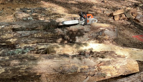

    To eliminate a double wood handling for refilling my personal use racks I was thinking about splitting this dead chestnut oak and going straight to my racks. Good to burn this year, or don’t bother?

    IME splitting dead barkless oak like that into thin boards, will make it dry enough by the middle of winter, as long as it's top covered with good airflow. I split some long dead white oak back in February-March and happened to check on it the other day. It felt more than dry enough to burn in the outdoor pit already, and should be stove ready by this winter.

    What's it measure for MC now?
    If its still solid, my experience has been it still takes at least two summers heat/breeze to get it there...

    I’ve had dead standing chestnut oak get to useable status (below 18-20%) very quickly. Even the heart wood. As long as it isn’t plus 30ish now, I’d say you’ll be perfectly fine burning it this year.
    It’s been my meat and potatoes for a while now, and will be for several more seasons.

    With your hot weather I'd say go for it. Split a little smaller. Worst case it gets used/sold the following year.

    I had a bunch of 36" red oak rounds (and other assorted bits and pieces from the same tree) that had been sitting in my wood lot for at least five years. I finally split most of it back in April, and while most of the splits went into a stack, I did try burning a few pieces (mixed in with some dry wood from the woodshed). The pieces I tried burned fine with no noted moisture escape in the wood stove. I never checked the splits with a moisture meter. These had been bucked into rounds several years ago whereas yours are in log form, however I would say go for it and get them CSS as soon as possible to take advantage of the summer to (hopefully) finish drying off. Worse comes to worse, put them at the back of your inventory for next winter and use them as far out as possible.

    Like The Wood Wolverine, I burn a lot of dead C oak that is cut in the spring, CSS and top covered in the sun and it is < 20% MC by winter.

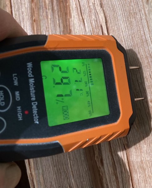

    I recently split some dead white oak that was incredibly light and on the border of becoming punk. That wood is in the rack for this year. So far the consensus seems to be go for it. This chestnut oak had been standing dead for 5+ years. We have had a record setting drought and 90+ deg days. If the batteries in the mm work I’ll post results later today. Haven’t used that in years.

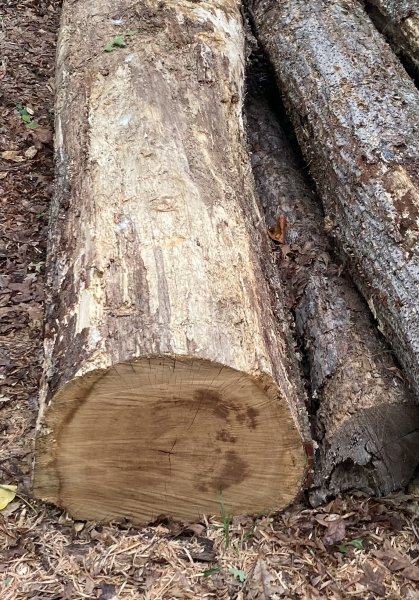

    Shout out to the world champion Canes. The cup is back in the south where it belongs. The boys are getting drunk on buses in Raleigh today.
    Tried to post a pic of a beauty wo log I’m fixn to dice up.
