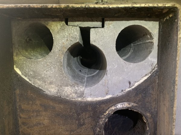

    Those bubbles help moisture escape as the refractory cures. ( looks like green or uncured refractory)
    Gasifier, brenndatomu and Eric VW like this.
  2. Eric VW
    24,542
    141,523
    That may be so, but in my experience of pouring refractory parts, it also shows a lack of sufficient vibratory action.
    fuelrod and Gasifier like this.
  3. Gasifier
    20,495
    104,020
    Alan. Do you think it should be warmed with several small fires. Then increasing the size of fires slowly to help the curing?

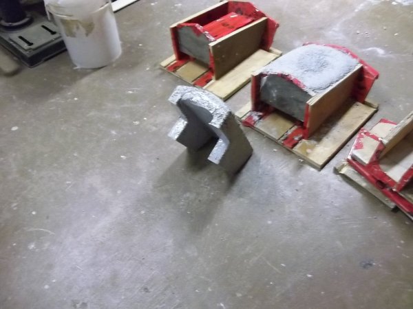

  8. campinspecter
    campinspecter
    1,684
    12,236
    It won't hurt . Going from room temp , to 2000 F in several minutes can have a very large expansion factor .
    I make my own nozzles ( each is about 40 lbs) very dense 3000 degree refractory . Before they are installed each get cooked in the kitchen range oven going from a 170 degrees to 550 degrees in 50 degree increments allowing for a half hour for every 50 degrees ,this process really stinks .Then when placed in the boiler I do five burns using 3lbs of fir kindling and 2 hours for each cycle . My home nozzles far out last the factory ones .

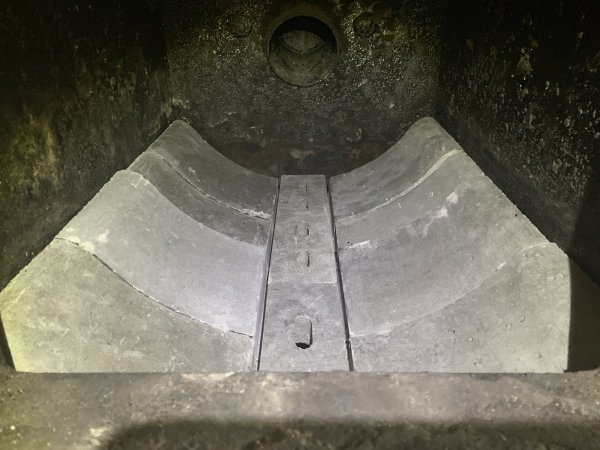

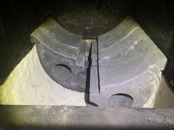

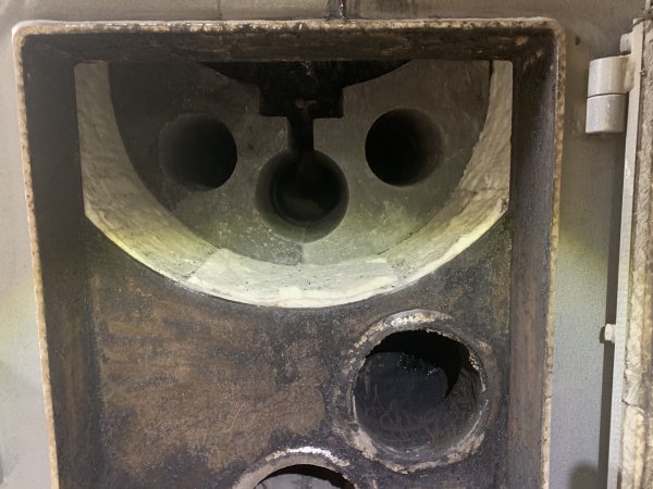

  9. Gasifier
    20,495
    104,020
    New blanket piece here and everything installed.
    A7538DDE-57BB-4566-AB4B-8F13E4B4F3A6.jpeg 06D90ACE-605A-4940-9783-BE8072B08BE6.jpeg 3FB3FBFE-C47B-4667-95B2-58FACA5E614C.jpeg 65AFCC2E-CFB4-4194-8AE3-568C812255D0.jpeg
    Everything seems to fit okay. Not perfect, but fairly close. Now to decide what I need to use the trowel-ease on. But first a short break for a little caffeine and breafas!

  11. Heat550
    Heat550
    Feb 3, 2016
    327
    2,249
    Minnesota
    So every 9 years they need to be replaced ? How much did new set cost ?
    Sent from my LGL84VL using Tapatalk
    Need2Saw and brenndatomu like this.
  12. Gasifier
    20,495
    104,020
    New full set of ceramics with new blanket and new nozzle bricks were $1300! :doh::picard:Oh well. In eight seasons I’ll save about $24,000-$28,000 in fuel oil cost. My boiler heats my large house, attached garage, and domestic hot water.

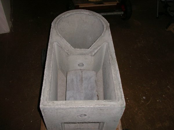

  14. campinspecter
    campinspecter
    1,684
    12,236
    Sounds like a good price!

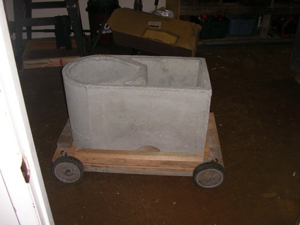

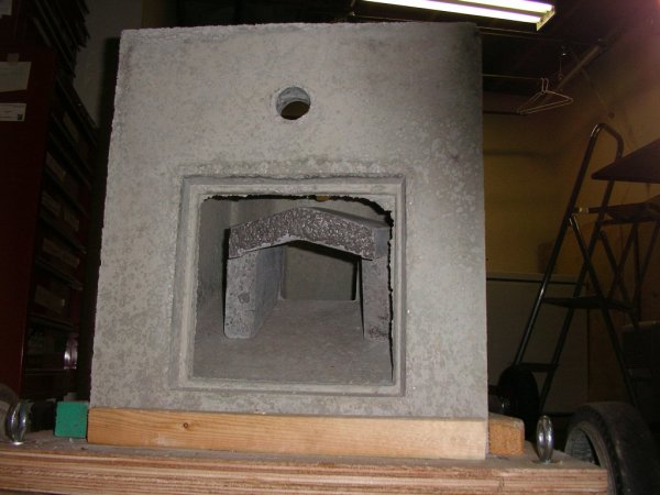

    The complete refractory for a Jetstream in 2011 was $ 1600 fob Turo, Nova Scotia
    It weighed around five hundred lbs.
    High density refractory is heavy and quite expensive and Gasifiers' would be very complicated to form. IMGP3372.JPG

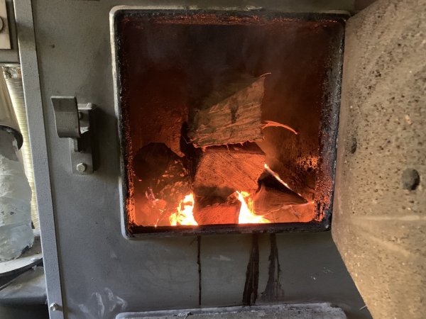

  17. Gasifier
    20,495
    104,020
    slowly warming the boiler up. :fire:
  18. Gasifier
    20,495
    104,020
    Wood Gun Gasifier is running smoothly. The colder it gets the smoother it seems to run.:thumbs:
