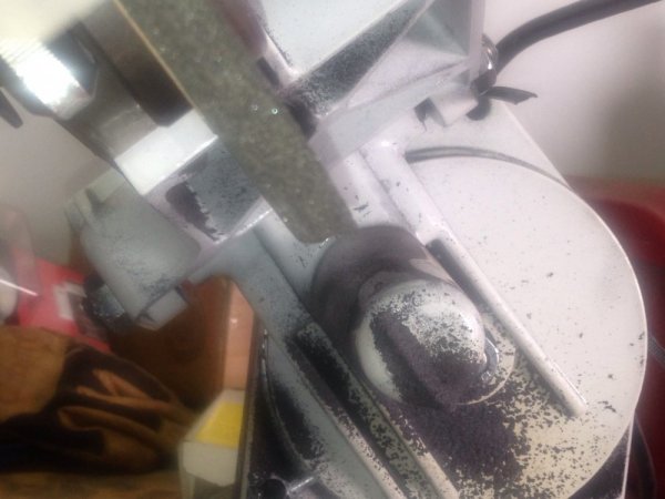

    Well I did a couple more chains today and must say it is a good sharpener however I really need a 5/16 wheel for the rakers / depth gauges. Doing it by hand is well not motorized therefore boring. :smoke:

  10. DexterDay
    DexterDay Administrator
    12,411
    31,637
    Northeast Oh
    You can "make" your 1/4" wheel into a nice Raker machine. Dress it well. MasterMech has a nice pic of his dressed. I don't know if his is 1/4" but mine is.
    There are cheap replacements online. I picked up two extra 1/4 and one 3/16 for $10. Let's you experiment.
    Chvymn99 and Pallet Pete like this.

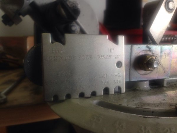

  12. MasterMech
    9,648
    26,044
    Greenville County SC
    Mine is the Stihl wheel that comes with my grinder, you could duplicate it by dressing to the same angle. The curve in mine comes naturally from hitting the rakers in the same spot on the wheel every time, only takes a couple loops to start getting that shape.
    Pallet Pete likes this.

  14. amateur cutter
    5,997
    48,770
    Dress you're 1/4 wheel in the same shape as MM's, do the rakers on all the chains first, then go back through the cutters. Fastest way I've found. Well, till I set up a second small grinder to do rakers anyway. Nice write up on the assy. & use. You might want to make some permanent scribe marks for the angles. My Oregon, the tags get hard to read after a while with grinding dust, wear etc. A C
