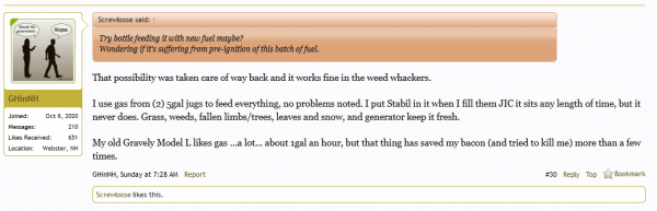

  10. GHinNH
    GHinNH
    Oct 8, 2020
    237
    837
    Webster, NH
    That possibility was taken care of way back and it works fine in the weed whackers.
    I use gas from (2) 5gal jugs to feed everything, no problems noted. I put Stabil in it when I fill them JIC it sits any length of time, but it never does. Grass, weeds, fallen limbs/trees, leaves and snow, and generator keep it fresh.
    My old Gravely Model L likes gas ...a lot... about 1gal an hour, but that thing has saved my bacon (and tried to kill me) more than a few times.

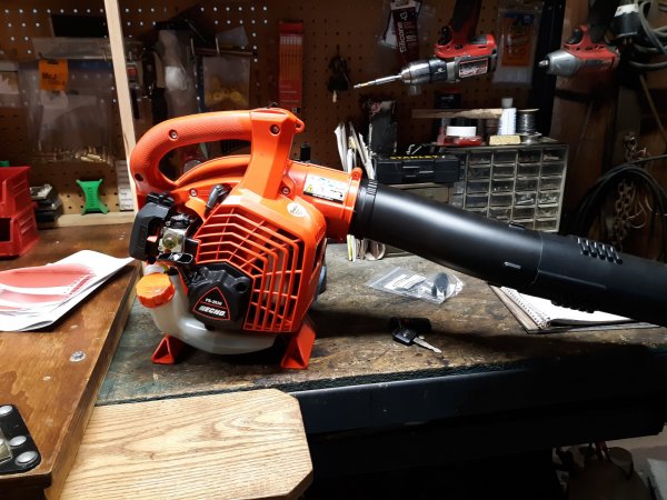

    Brought it back to where I got it at the dump with a note outlining everything I'd replaced, what I had done and how it was acting, followed by "Good Luck" for the next guy.
    Called independent Echo dealer in Concord and snagged this puppy. Decently below MSRP, but $10 more than I could find it for online, but if you add shipping it was actually cheaper. Plus I have a place to bring it to if something happens during the 5 year warranty period.
    I looked at the parts breakdown for Husquvarna, Stihl (good luck with that one) and Echo to look at the mechanics and engine design, decided to go with it, besides it matches my trimmer.
    Kinda strange actually having something brand new, 50-1 oil ration!? What? I mean who has ever even heard of such a thing? :rofl: :lol: Good enough for me to blow the leaves along the woodlines, gully's and other impossible to reach areas onto the grass, so my sweeper can get at them. That and all the other little chores I use one for.
