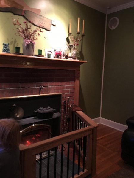

    So I’ve had this suncourt through wall fan sitting around for a year. Bought it to put between the stove room and bedroom that gets fairly chilly with the door closed. This room is where the new baby is now so with the extreme cold they’re forecasting I figure I’d get it done. Install was easy which I knew it should be but you never know what your going to find when you cut into the walls on a old house. The fan is corded and I’m not too keen on how the cord looks hanging down from the wall. I’ll run the cord through the wall cavity and hardwire it in somewhere in the basement eventually but that’s a project for another day(and one that will definitely involve expletives).
    The bedroom with door shut is usually around 55-65 depending on outside temps. Stove room hovers around 70-80 depending on temps and how hard I’m running it. The fan has been running for about 6 hours now and both the stove room and bedroom are 74. In the short term I’d call this a success. I am just curious how this will effect the flow in the rest of the house. I can definitely feel a different air flow from my normal spot on the recliner. Haven’t checked the temps upstairs to see if they are different than the norm. Anyone using fans such as these? Positives/negatives/ observations?
    Fan is up to the right.
